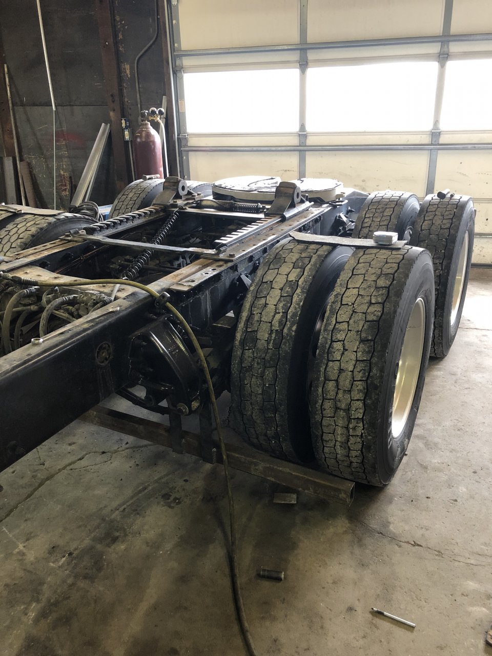

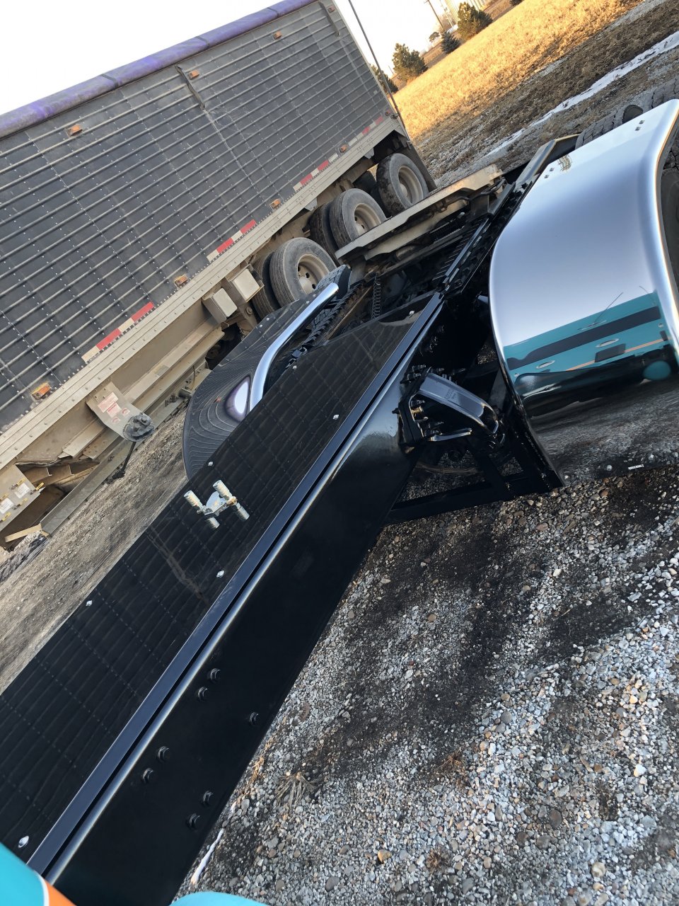

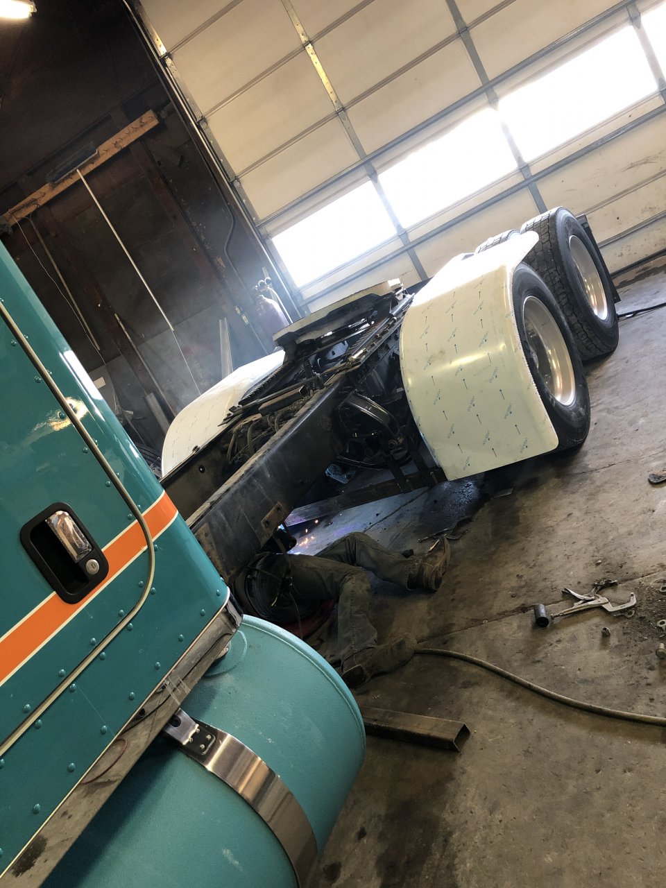

    The truck I bought was a factory 4 axle with a steerable lift. I knew when I bought it that the axle would be coming off as I have no need for it. So this weekend with the help of a friend we yanked it off.
    Axle is off and fabbing up a blind mount bracket for the fenders.
    Because it had a lift I had to move the 5th wheels slide back 12”. At the rear most position it is now centered between the tandems.
    Test fitting the new deckplate that I had a local shop build for me. Also the spare holes from the axle were welded closed.
    Some fresh black paint.
    And done with everything out together and fenders mounted.
