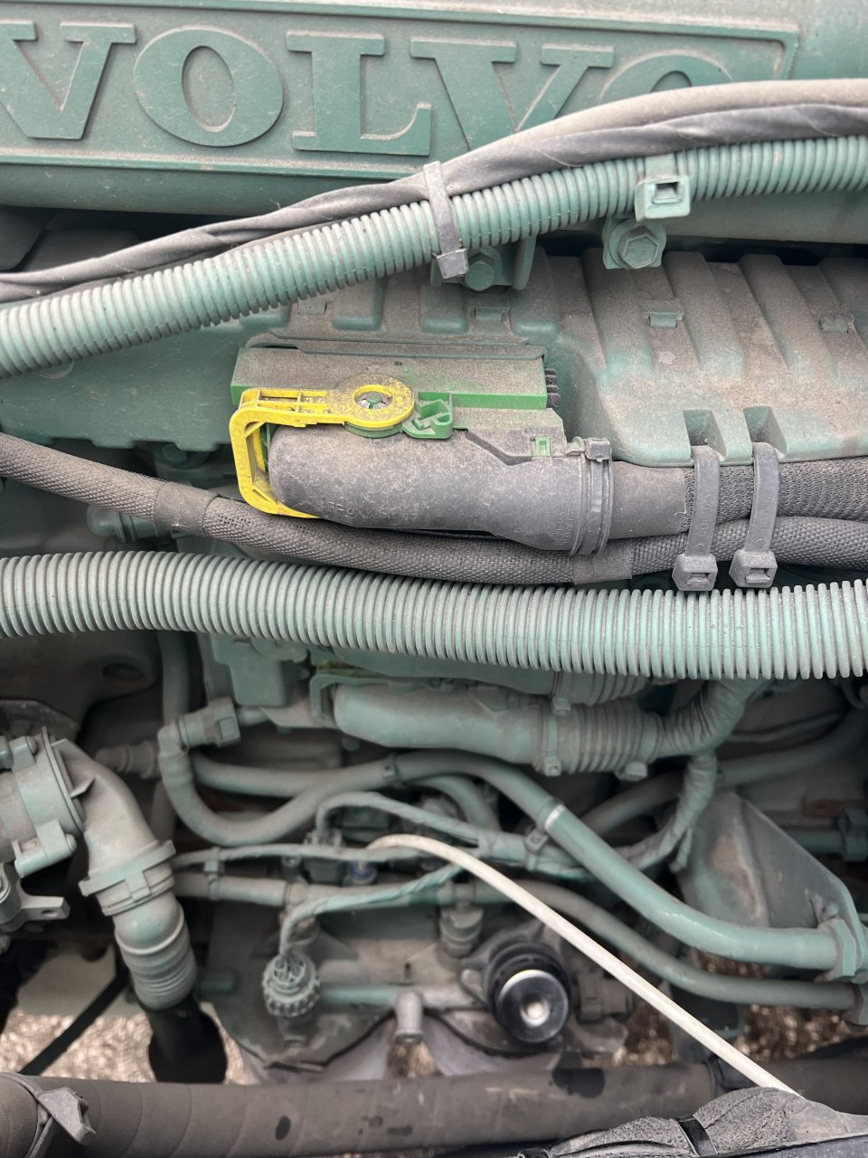

    @YoungGAtrucker25
    Can you post a picture of your fuel filters, should be on drivers side, so we know what system you have and can maybe describe more accurately what you need to do to get it going. Not close up, from front to back of engine basicly
  9. YoungGAtrucker25
    YoungGAtrucker25 Light Load Member
    118
    196
    Sep 10, 2018
    Yes I’ve been doing that but no response
    My arm hurts and I smell like diesel so bad I’d be toast if I catch a spark lol
