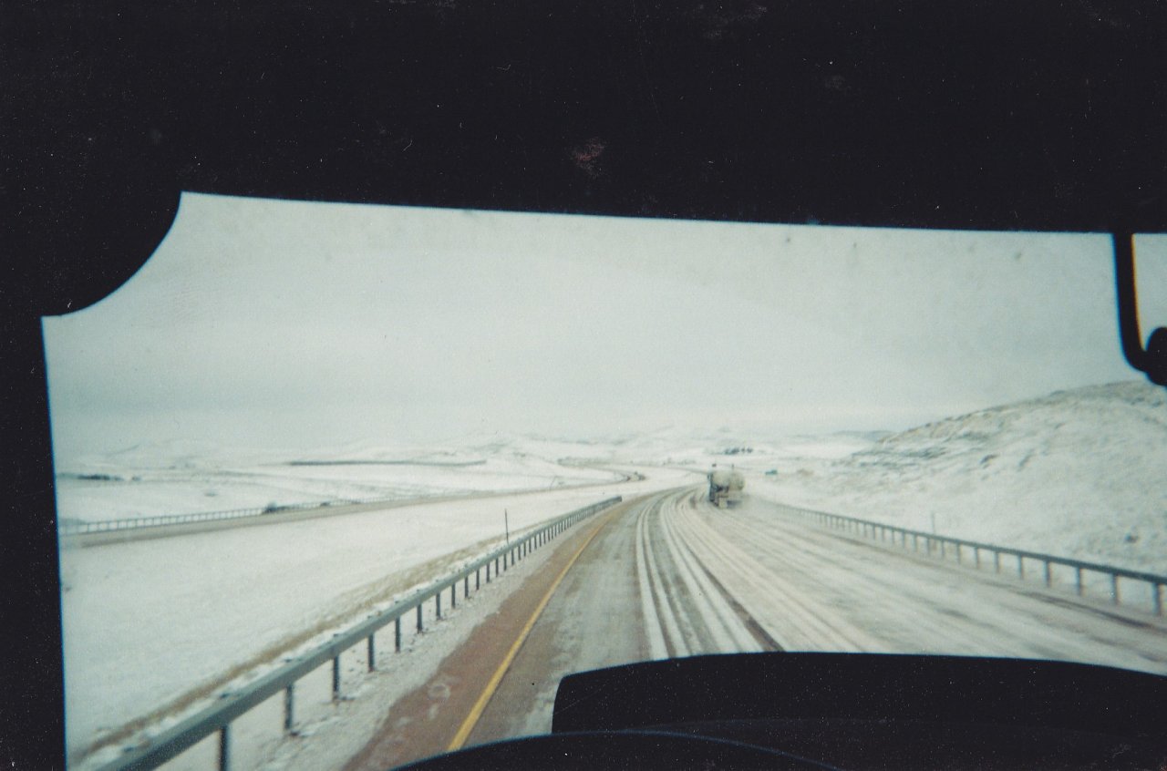

    The first time you break traction, you decide to put on chain or go find a place to park, one or the other.
    Ive got a couple images of myself and a rocky doubles tanker working our way towards Sheridan WY from the southeast on a particularly icy and chain beaten section of interstate somewhere at 10 for him and 15 mph for me. We were using the dry side of split ice on both shoulders to make it work.
    I remember that day more than anything because he was very good at what he was doing locally because he did it all the time and gave me lessons on the ice school via radio, tanker style.
    BlackjackCo, 201 and BUMBACLADWAR Thank this.
  9. BUMBACLADWAR
    BUMBACLADWAR Road Train Member
    1,899
    1,923
    Dec 5, 2013
    Looks GNARLY...TO SAY the Least.
