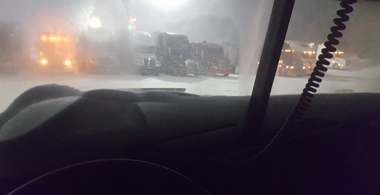

    Something that I'll have to look into here I only have my truck heater on and it's sticking..
  6. Final Drive
    Final Drive Road Train Member
    1,573
    2,505
    Jan 21, 2015
    Same situation but nothing is sticking to the windshield..

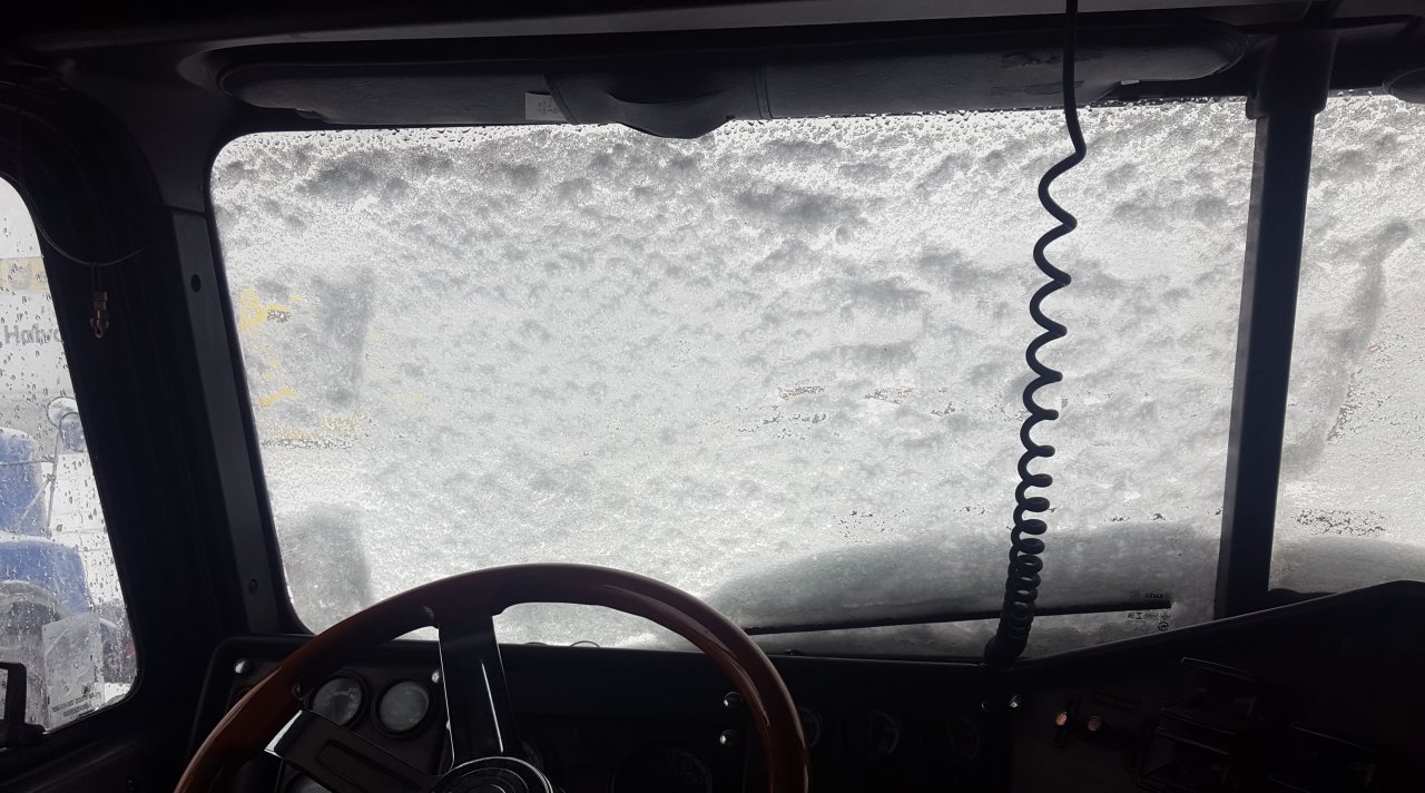

  11. gentleroger
    gentleroger Road Train Member
    7,915
    21,674
    Jun 1, 2010
    What I've noticed is that ice starts forming on the arm/back of the blade first which ends up pulling ghe blade away from the glass every so slightly. It doesn't seem to matter what you do with the cab hvac in that situation. When I'm driving in that type of weather I just plan on stopping every hour or so to knock the ice off the blades and clear the snow from where the wiper doesn't hit. I also clean the brine/salt off my mirrors and check my tail lights are clear. The leds don't melt the snow, so its very possible for the back of the trailer to be completly snow covered, camouflaging you to overtaking traffic.
