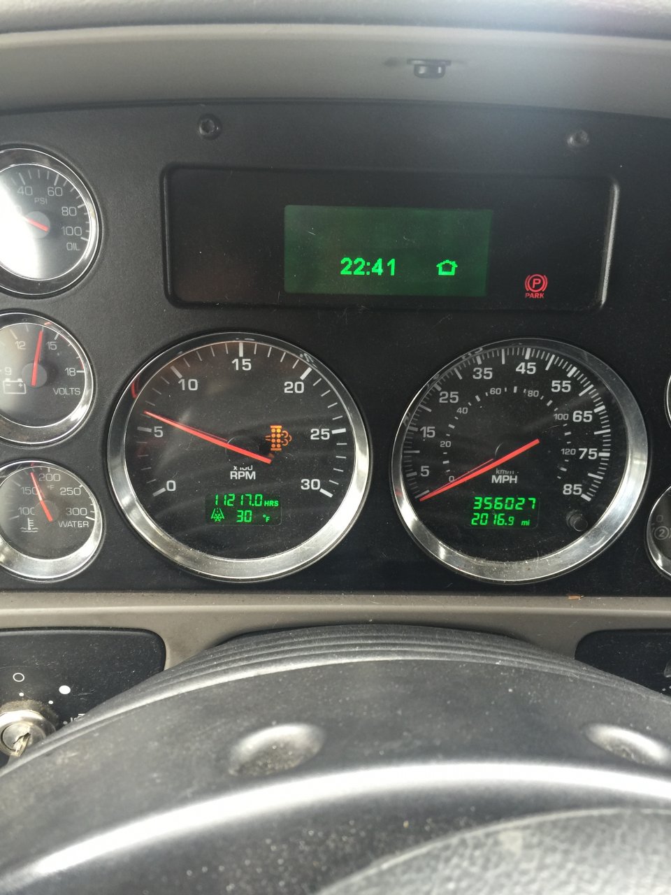

    It's a 9 speed this light just popped on idk of its regen light or prob with regen. Because the same regen light also comes on by the time screen when time for regen

    So are you saying it's prob already messed up or that's a sign that it's going to mess up. I drove all the way from Indiana to virgina 11 hours non stop light still on. Doing a park regen now. Company says I have 30 days before I make a payment.

    go to Cummins dealer and check your engine number. that engine may have been updated already. if not then buy a new pump and replace it.
