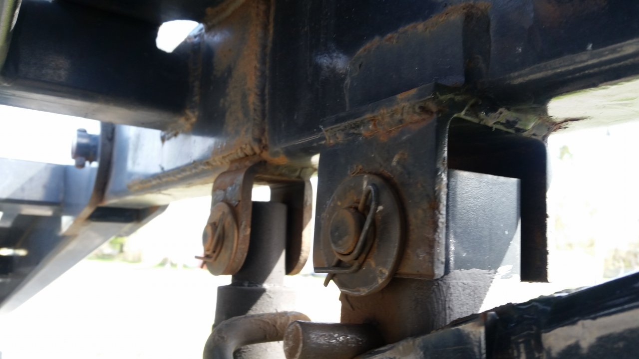

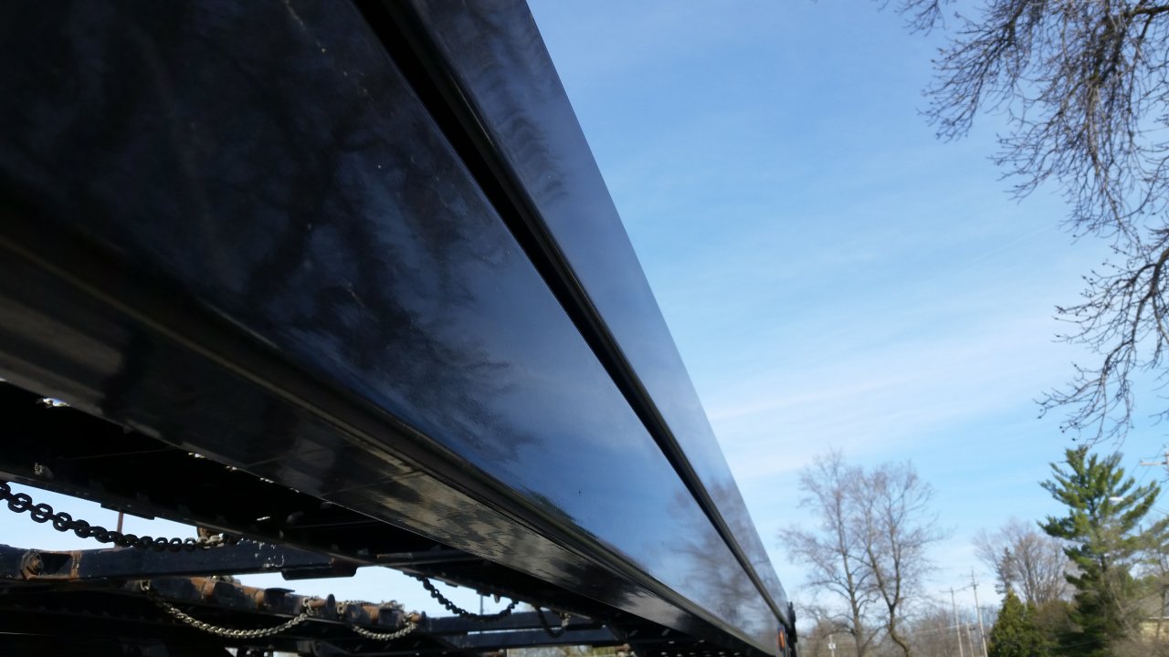

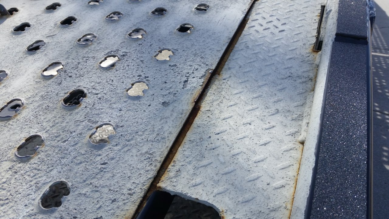

    Yes, the quality is gone. I was a die hard Miller fan most of my wreckers were Chevron or Vulcan which are Miller brands and so were our first two trailers. This 2014 was never right from the start, the upper deck bows out in the middle, caused two hydraulic fittings to shear off while predelivery inspecting when I went to pick it up. Their fix was to cut the lift piston mount and move them 3/4 inch off center to compensate. A month later and the main cross beam (4" square) cracked and they boggered the fix on that as well. Also, every cylinder has been replaced under warranty and most are leaking again but now it is out of warranty. Lastly, paint is coming off already, rust coming through ( and I wash it every 2 weeks to prevent salt buildup), and the decks are cracking/tearing at the spot welds.

  6. Terry270
    Terry270 Road Train Member
    1,455
    1,678
    Jan 21, 2014
    BG, KY
    Holy ****. I can only imagine how pissed you must be. The 02 I sold in January was ready for a repaint but otherwise good to go
