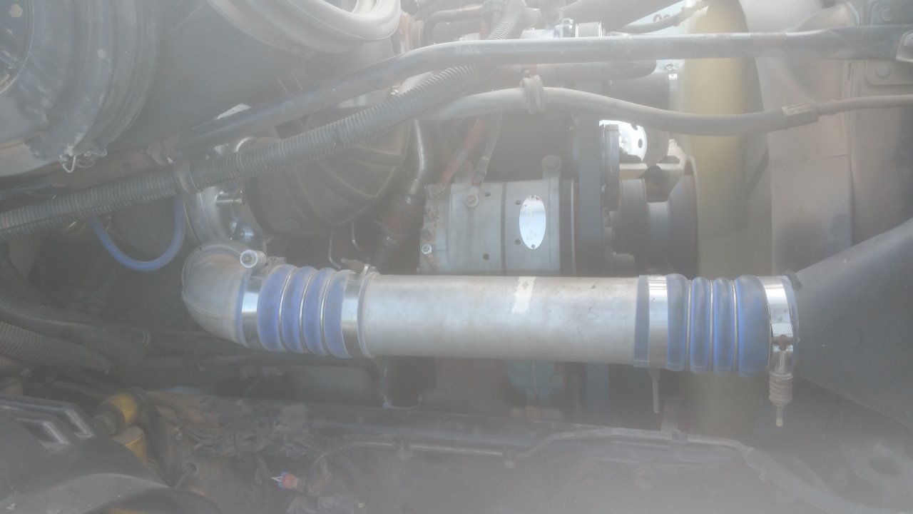

    Sorry for the delay replying.
    I asked the owner what turbo he specified and he said, "A regular turbo"...
    ... that was a big help. Here's a picture of the new turbo, looks like a "Warner" brand.
    Fuel mileage has suffered, but that's largely a function of idling in this heat. Otherwise I think the fuel mileage would hover about the same.
    The first difference I see is that there is no lag for the turbo to "lurch" into action like the old EGR setup with the turbo actuator, so there's smoother acceleration. The second BIG difference is just the overall added power. Normally in Texas I set the cruise control at 70-72 mph on highways and freeways.
    It used to be that if I was overtaking a slower truck and a hill was approaching I might as well fall in behind because I KNEW if I tried to pass it would block traffic and I would end up having to fall behind anyway, even while deadheading. Now I LOOK for hills as an opportunity to pass with any load up to 30K lbs or so. If I'm loaded heavy I can hang with most anyone out there now on a pull.
