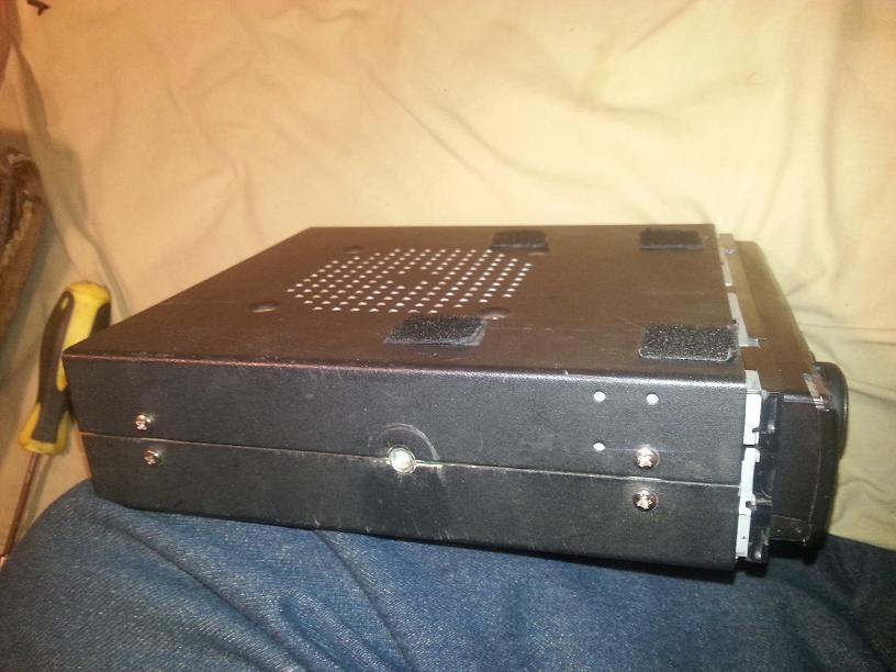

    Okay, we all know the factory stereo in most road tractors is anything but sufficient. About the only thing they have going for them is newer units have Bluetooth and support USB (and a major fail by not supporting Android devices). Not to mention that some QualComm setups are known to lock out one channel indefinitely (usually solved by going to HOS menu, by the way). And most trucking companies do not allow upgrades of the stereo system, especially if it involves altering wiring. I'd had enough of all this crap, and I had noticed that the standard single-DIN receiver size fit a CB radio mounting bracket near perfectly.

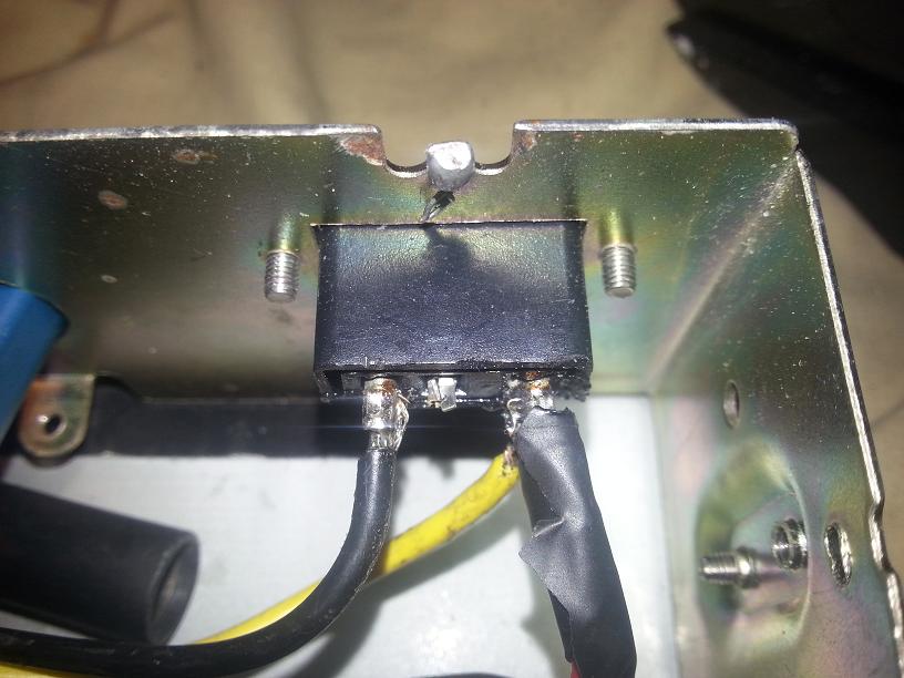

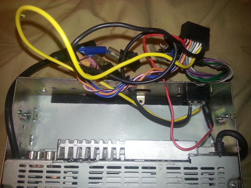

    Maybe I had found a way to get away from those pesky QC interruptions, and have great sound without touching the truck's factory setup or altering wiring. I started with my Alpine CDA-9884. Great unit, if a bit underpowered (18x4, Alpine? REALLY?). I then found an old Cobra 29 that was fried and otherwise useless. Removing the case halves, I removed the screws securing the radio electronics and faceplate and control knob assembly to the internal frame. Then I removed everything electronic, stripping the frame to little more than the factory power socket, to which I soldered the Alpine's 12V, memory and ground leads to the corresponding pins on the Cobra's power socket. Photo for clarity... (2-pin setup shown, center pin can be used for the memory lead with a three-wire 12V Cobra cord available in most truck stops, but it isn't necessary, I've run this one on a two-wire socket for over a year.
    To clarify. Items I tossed in the conversion: Original Cobra CB electronics, Original Cobra CB faceplate and control knobs. Cobra faceplace COULD be modified to make this a bit more flush and professional-looking, but I don't recommend it with head-units with flip-down or motorized faceplates.
    I found that it was necessary to bend a few tabs on the Cobra's frame skeleton to allow the Alpine's chassis to sit in the case, but once I figured this out, it fit nicely in the case as though it were designed to. For some reason, I wound up inverting the CB case's inner frame upside down, possibly because I was converting an older case with the mic on the side. When finished, the unit should protrude from the case just enough to snap the head-unit's surrounding trim bezel in place.
    NOTE: You may want to bend one or two of the CB frame's tabs inward to lock the head unit in firmly, and you may want to use hook-and-loop or rubber strips to cushion the top and bottom of the outer case, as I've noticed the outer case has a tendency to sag in the middle on the top and bottom. Merely a cosmetic issue, though, does not affect operation. See the finished product here...
    One nice thing about this setup is that Cobra CBs use a modular three-pin socket/plug arrangement, even though most CB radios only require two wires. Two-and-three-wire 12V cigarette lighter plug harnesses are available in any truck stop. Newer ones actually have provisions to use the plug's center pin, but it isn't necessary, I have been running mine with the memory and 12V drawing from one pin.
    If you're interested in doing this, most CB shops will have burned-up radios that others elected not to fix. They may just give you the case and frame just to get rid of it. When finished, depending on how you have it set up and mounted, you can remove the whole unit from the vehicle to take it with you if you wish. If you want to mount this setup with a standard Cobra bracket, it may be necessary to install outward-facing screws from inside the unit for securement -- the head unit will prevent any outside bolts from threading in. I simply hook-and-loop mine in place.

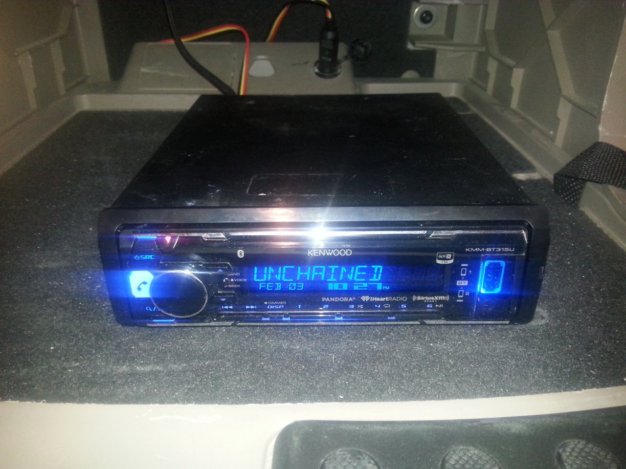

    So my iPod finally decided to quit... After a bit of research, I decided to upgrade to a new head unit with Bluetooth and USB/SD capability. I chose the Kenwood KMM-BT315. This is how it turned out....
