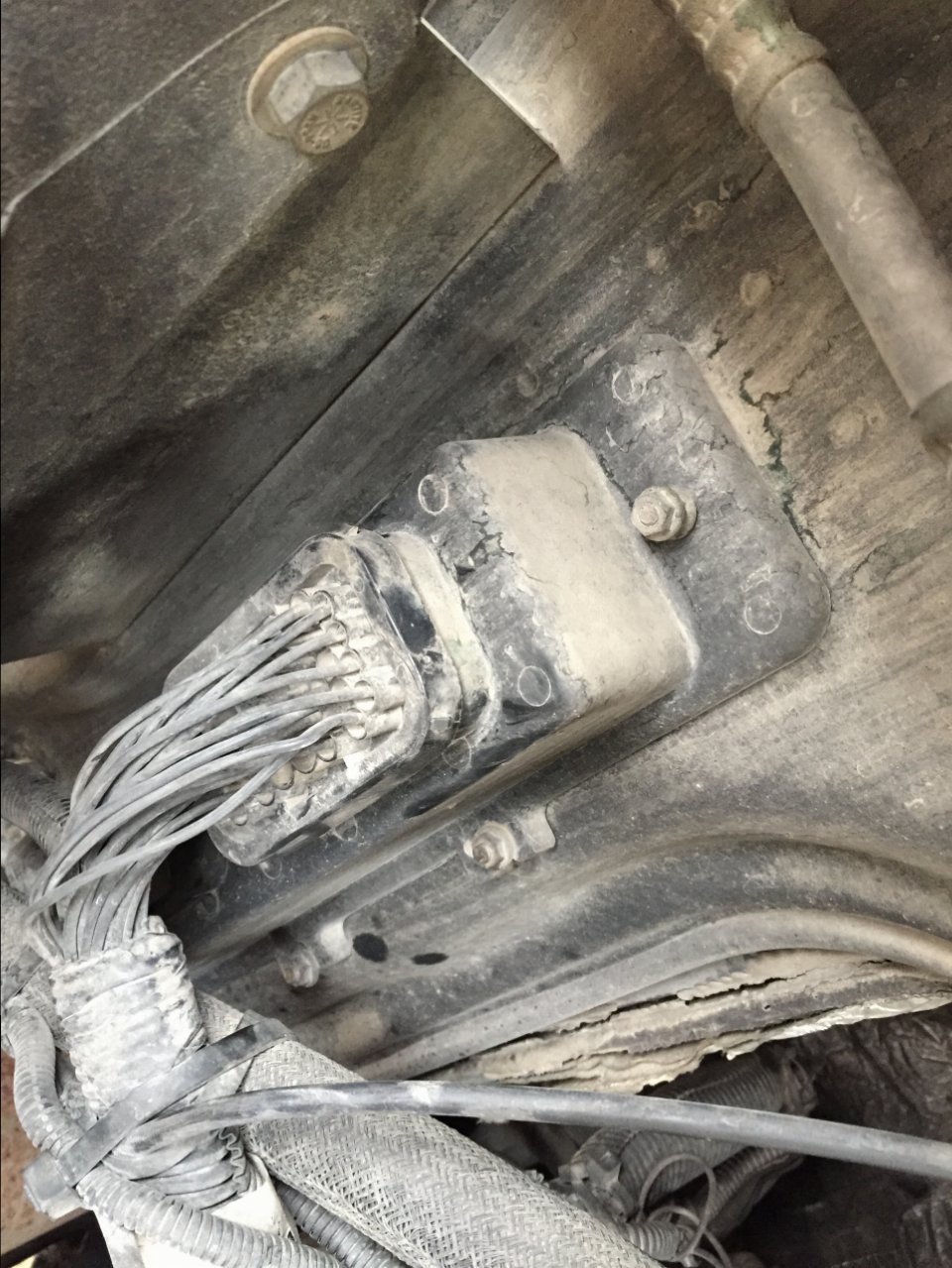

    Would I split that to both black and brown terminals?

    Should just go to the brown.

    Engine compartment. Left side. There's a black electrical box. When I lost my trailer marker and taillights, two fuses in there had blown. Didn't realize there were two, I just replaced one.

    Only electrical panel I'm seeing on left side, am I warm?

    Black box with a lightning bolt on it? Just above the steering column

    No luck there my friend. Only thing above steering column is air distribution valve, but all is not lost. I am learning a lot about this truck. :). I appreciate all your effort. Maybe I have a hybrid..

    Ah, I just noticed you have a VNL770. Mine is a VNL780. They may have moved it to where it is on my truck when they did the redesign.

    On the current VNL series Volvo put the fuses and relays for the trailer harness in that black junction box just above the steering column.
