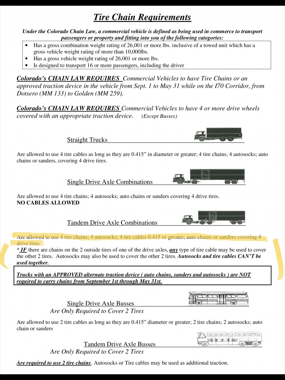

    Are cables a legal replacement for chains in all states?

    No. For example, Colorado. You can use cables on one axle, as long as you have chains on the other.
    Edit: looks like you can use strictly cables, as long as they are big enough.

    Colorado does allow cables but they must be the right ones. With Super SIngles there are restrictions, but anyone driving that wide of a tire on snow or ice is crazy wild anyways.
    Tandem Drive Axle Combinations Are required to use 4 tire chains; 4 autosocks; 4 tire cables 0.415” auto chains or sanders covering 4 drive tires. IF there are chains on the 2 outside tires of one of the drive axles, any type of tire cable may be used to cover the other 2 tires. Autosocks may also be used to cover the other 2 tires. Autosocks and tire cables CANNOT be used together. *Super single configurations require all drive tires to be covered.

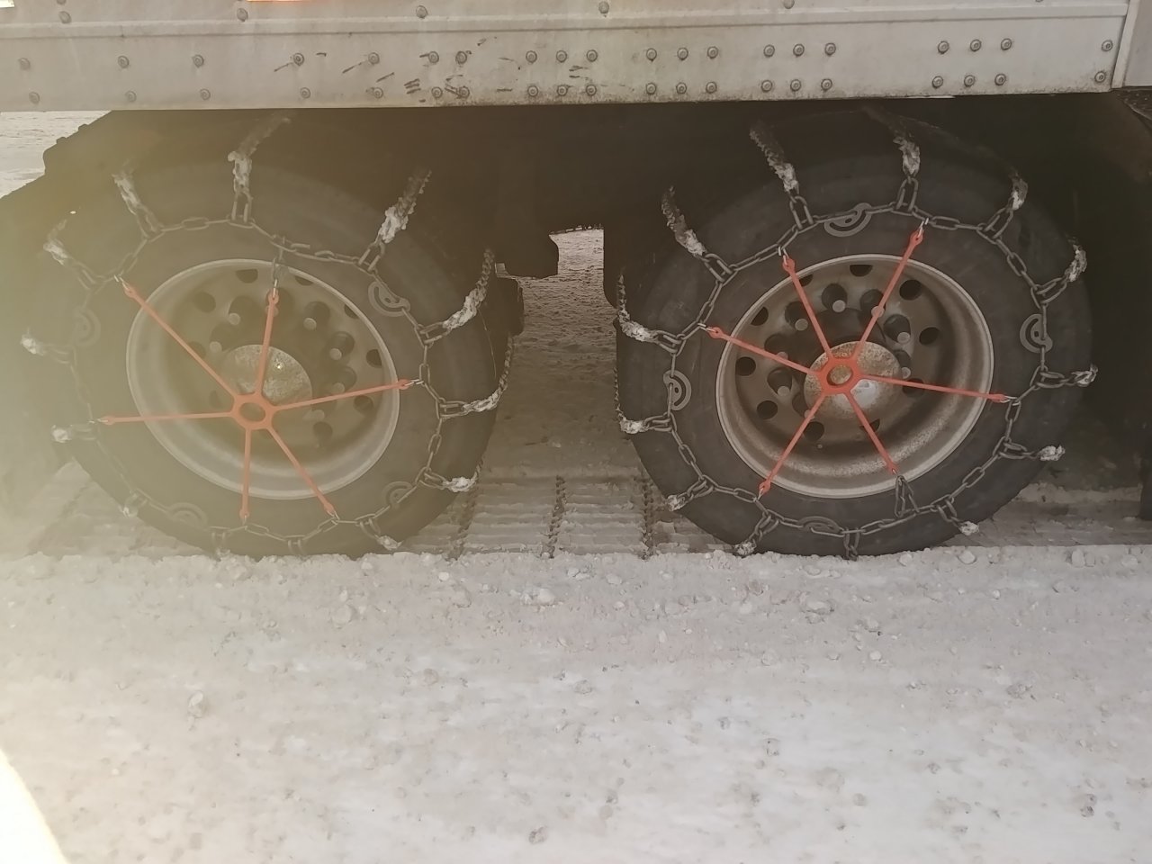

    Chains only.
    One of our members was using socks for a short while.
    Now he uses them as part of his dunnage.

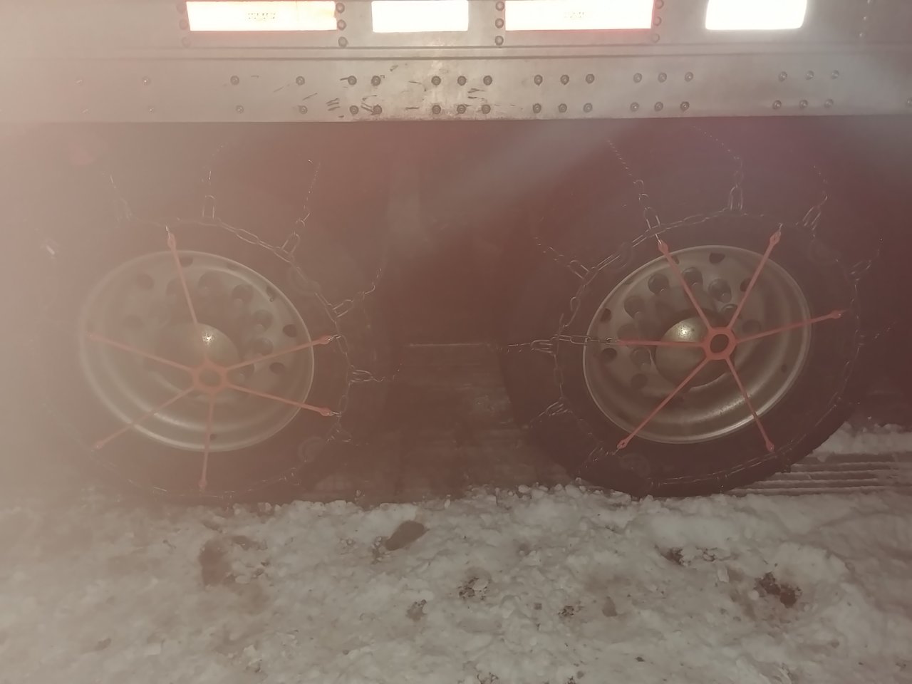

    Some wealthy fellas can afford them fancy high dollar bungees.
