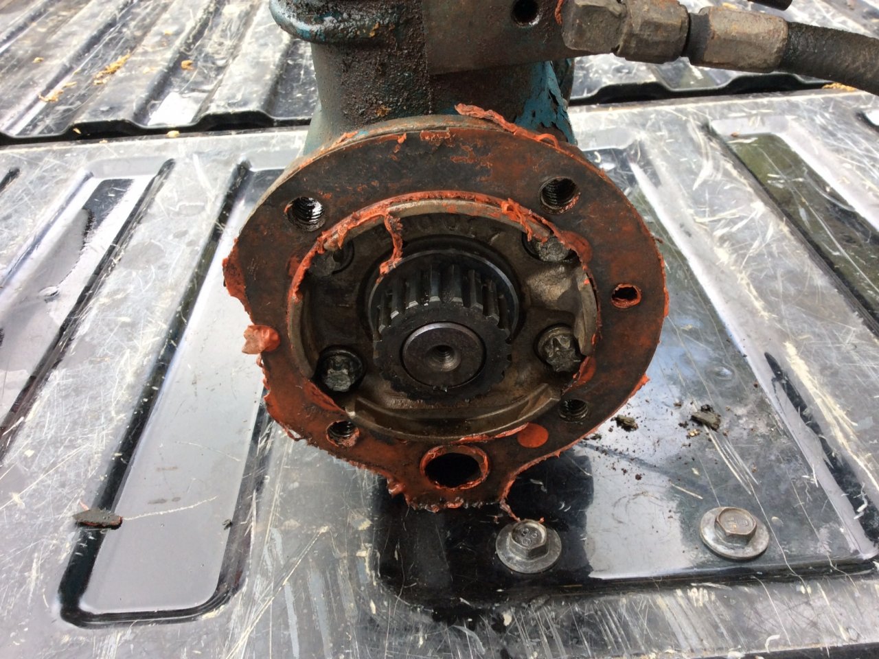

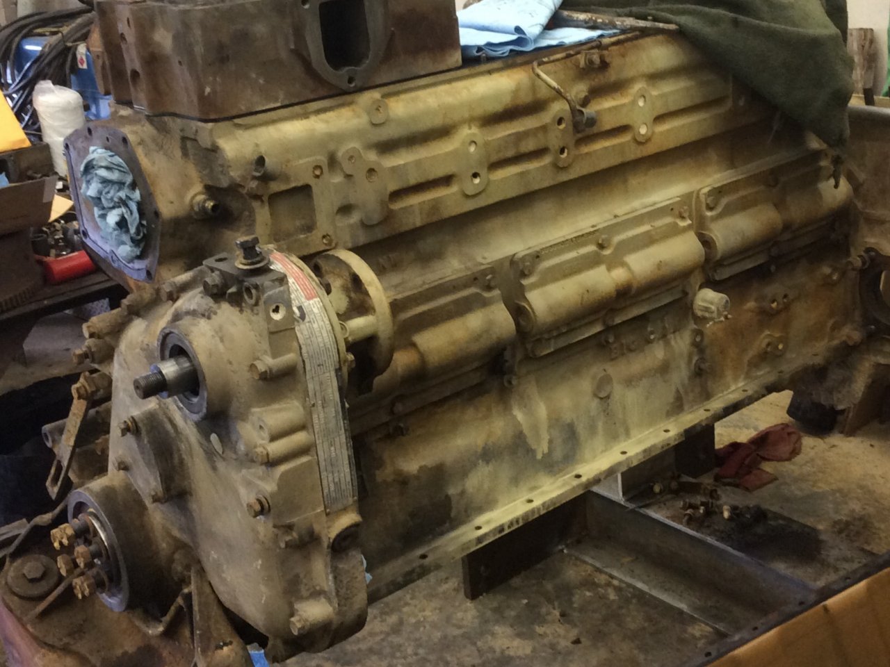

  7. OLDSKOOLERnWV
    19,116
    289,040
    As @blairandgretchen mentioned, replace the bushing and the seal in the accessory drive, you will have to remove the compressor and accessory drive shaft itself for that. This is a Big Cam in the picture but will help illustrate.
    Atruck Thanks this.

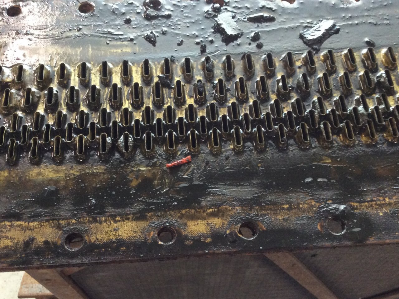

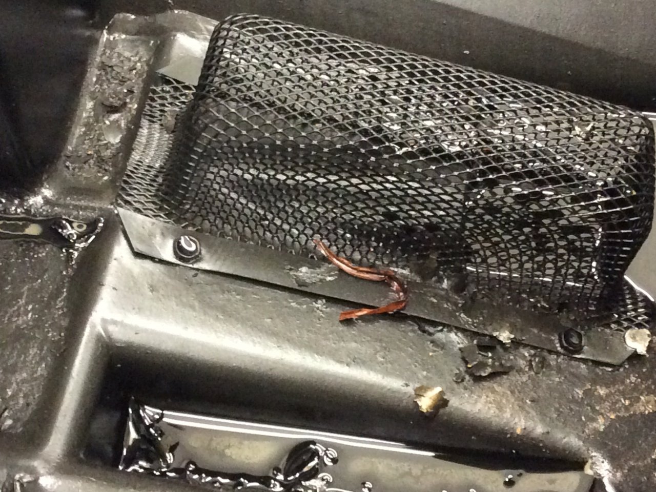

  8. OLDSKOOLERnWV
    19,116
    289,040
    When I bought my truck it had engine failure so I knew it would be a project. DON'T go crazy with silicone..... I found that stuff in the oilpan suction, in the radiator when I recored it, it was everywhere!! Every mating surface on the sides of the engine showed excessive use of red silicone.
