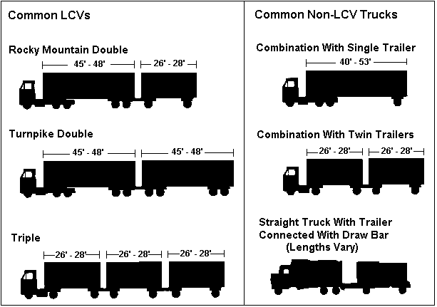

    Excuse my ignorance fellas, but what are "Rocky Mountain Doubles"? a double set of 53 footers??

    45-48 foot as a lead trailer and a 28-29 ft short trailer in the back. Turnpike would be two 45-48ft trailers.

    For the American versions of LCVs (Long Combination Vehicles)
