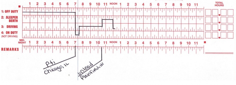

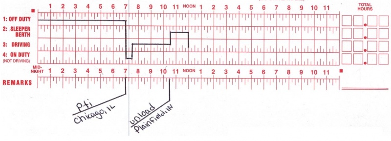

Vertical lines indicate a change of duty status - from sleeper to driving, etc. Horizontal lines show how long you were on that particular duty status.
I see no difference between the two images as far as indicating a change in duty. If I stopped you at 1300 hours either one of the examples would be current to the last change of duty status, the last time you started driving, as long as you had been driving since noon.
However, as has been mentioned in this thread, I am missing seeing some line 4 time for your unloading. -

I told to log that 15 minutes of driving time in orientation by the log instructor to show that driving began, not so you could change it later if needed.
I do Intermodal aka Containers. All the customers we go to.. we back into the dock and come out and ask us for the pick up #, once they are done, they come out and sign the delivery slip OR give you a BOL and off you go. Most customers that handle containers do not allow anyone to go into their warehouse. I suppose I'll just log 15 minutes on duty/not driving then hit the sleeper for the sake of any trouble...
Unless they stop you at the gate or you hit a scale withing the first 15 minutes how are they going to know? Either one would work for me. Do what your company wants you to do and then if you get dinged you hand them the ticket.
line one is the right one for the not going on duty that's a hole different can of worms both of you would be wrong there whither you have to go in or not you still have to open doors or if flatbed untarp and unstrap
JJ, Carrier is going to accept what they can get away with and what's in their best interest like you protecting your 70. Swing down to 4 and catch a qtr hr. for the unload every time . You saw what Scalemaster said........cover the 6 driver......
