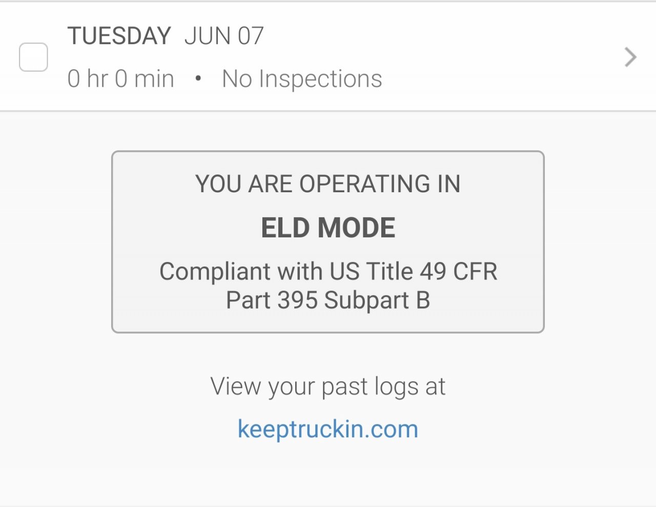

    Open the app and scroll to the bottom. Does it look like this?
    Siinman Thanks this.
  6. skallagrime
    skallagrime Road Train Member
    3,855
    9,927
    Apr 10, 2012
    Indiana
    How old is your truck/engine model year?

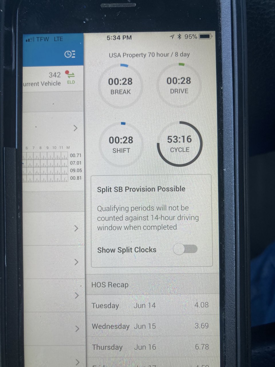

  7. Judge
    13,783
    91,622
    And if your J1939 pin gets a loose connection from a big boot bumping it, it puts a red dot.
    See ELD red dot.
    says lost engine hour synchronization, but it still counts drive time. :(
    I’m 93 mile from destination, but i’m legally unsafe to drive.
  8. Ducktart
    Ducktart Light Load Member
    80
    84
    Jul 13, 2014
    2018
  9. Ducktart
    80
    84
    Jul 13, 2014
    Nope
    God prefers Diesels Thanks this.
