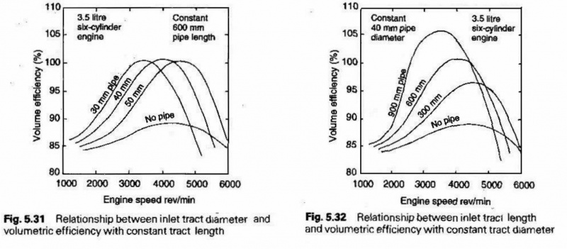

I have to disagree with Veltman on this point. High performance naturally aspirated engines have been exceeding 100% VE for decades.
To breathe in more than 100% of the available air, these engines use acoustic tuning (technical term: Helmholtz resonance). By adjusting the length of the exhaust headers & intake manifolds, engine designers can tune for a narrow range of rpm where the sound waves (from combustion or closing valves) reflect back at just the right time to force a little extra air through the intake or to suck just a little extra air out of the exhaust.

This is why when you buy headers for a popular engine, say the 350 chevy, they often have a number of options to suit various applications (longer tubes generally being tuned for lower rpm, and shorter being tuned to use fractional wavelengths for higher rpm).
