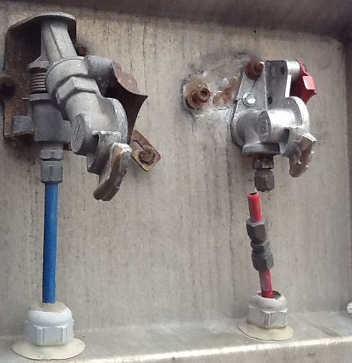

    Our maintenance had a nearby road service call me. I explain the problem, the gladhand receiver unit on trailer has snapped off and broken the red, emergency air line. He says he'll come out but can't fix it here. ???? I tell him let me talk to my company.
    I learn of a closer outfit that does breakdown service for FedEx and call them. They can be out in 30 and can fix it here. I call maintenance and the decision is up to maintenance. The second company comes out but it takes more like an hour. All this time I can see 100 feet in front of me where I need to spot this trailer. Fortunately, I'm on private property and they are not just nice, but very helpful.
    The mechanic has the right gladhand receiver unit but instead fabs up the same thing that broke off. I tell him, hold on--let me call maintenance. Maintenance talks to him. I ask the mechanic what maintenance said. "They said get the parts and fix it right." I smile.
    Then he's talking about charging us for driving back to his shop for parts. Has to do this, do that. I'm no mechanic but I can see access holes to the air lines underneath the trailer. He decides he can splice the air line from above, now that it's obvious he can splice new line in from below. He gets the right fixture mounted but has a 90-degree elbow at bottom pointing out from the trailer.
    "I don't think that's gonna work," I tell him. Says he doesn't have the right fitting but will look again. Finally he scabs the fitting from the part that broke off. When it's installed, he says he doesn't have anything, any silicone, RTV or other sealant to position the air line into where it dives down into the bulkhead. I patiently explain that DOT will look for chafing there.
    He comes up with black silicone and it works. $242.37 total and we provide a comcheck on the spot. It's a lease trailer, leased to our customer and I call the customer's leasing company, email photos and a pic of the invoice and copy all that to my company. Happily, I learned that they agreed to pay.
    On any given day it's called trucking.
