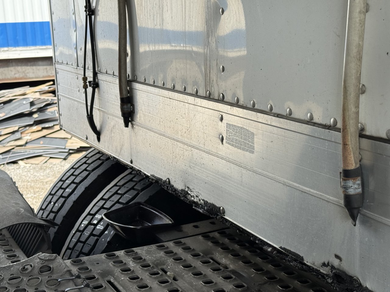

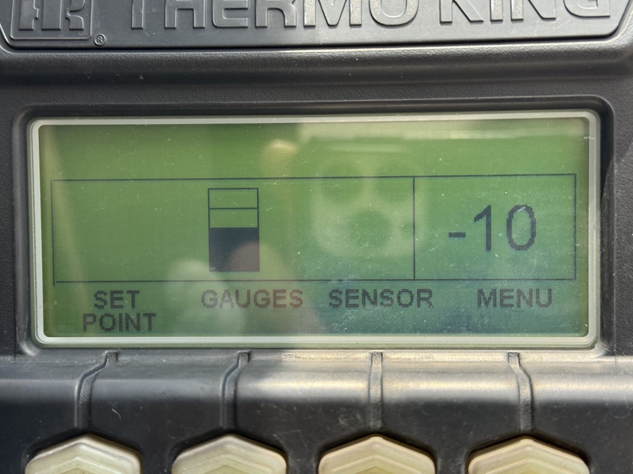

    Hi everyone. I set my temperature to -10 2 days ago and still hauling the same load but the unit is still running at high RPM. When its reach to -10 the engine running lower but its going down to 0 quickly and running on high rpm again. It’s not doing defrost even if i push the defrost button there is no any water coming out from the drain hoses. There is no alarm code. Please help me! this unit running on #### high rpm since 2 days

    Yes it’s doing defrost when i push the button and some of parts in the unit getting defrosted but the problem is It does not start defrosting unless I press the button and there is no water coming out from the drain hoses while doing defrosting. So the unit still running on high rpm.

    I saw that some of parts inside the unit was iced up when i open the unit and i push the defrost button it got defrosted the parts. But no any water coming from the drain hoses and running on high rpm since friday. The product is frozen fries. I turned off the unit 15min ago and waiting to see if draining water. I am in chicago right now and will deliver it tomorrow morning.

    If no water comes out you're not froze up and you have some other problem.

    It's been 50 min since I turned off the unit and there is still no water. I guess i have to turn it on now back again.what kind of problem i have?this unit is 2015 and only have 6k hours on it.

    Btw i just turned on and it got started to defrosting automatically but still no water. IMG_4899.jpeg IMG_4898.jpeg
