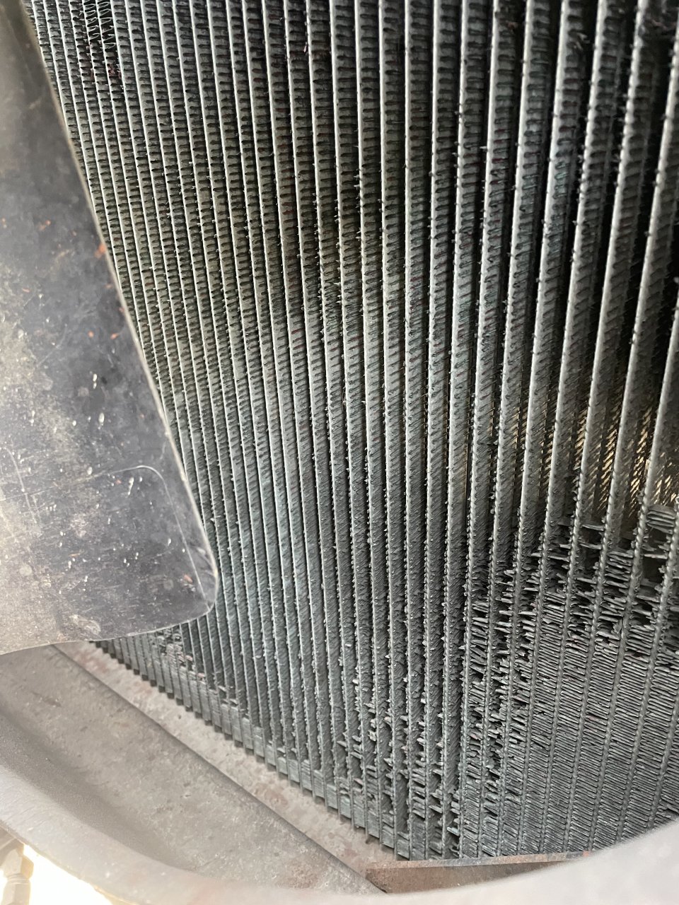

    Spoke too soon, granted the engine fan crashed the radiator last july when my motor mounts gave up, but no leak till this week, a small leak and 3 rows of fins gone.
    i probably could have gotten away with just the core for half the price, but im replacing the whole assembly.

  8. skallagrime
    skallagrime Road Train Member
    3,856
    9,943
    Apr 10, 2012
    Indiana
    Ouch. 400k ish ago on mine

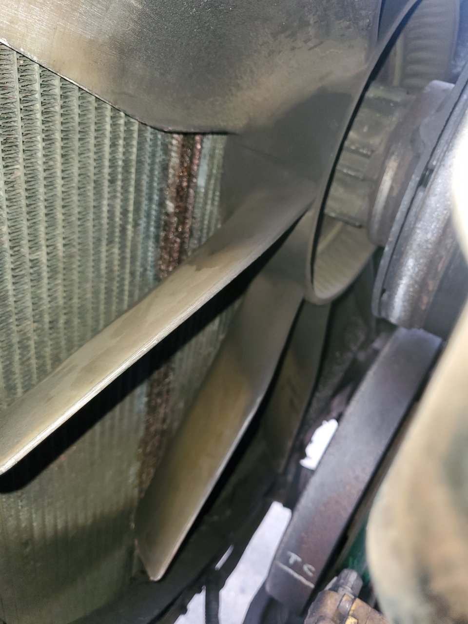

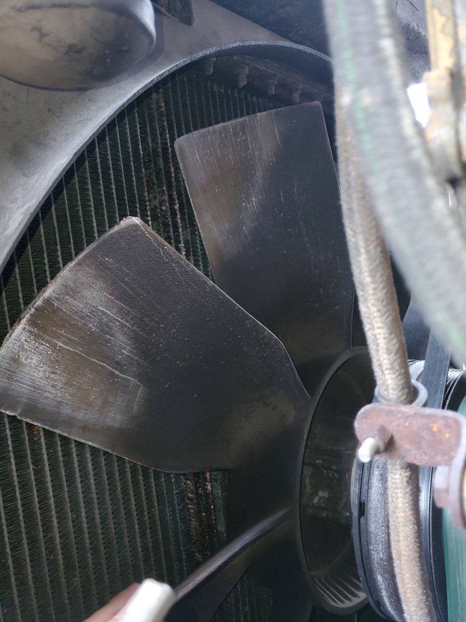

  10. skallagrime
    3,856
    9,943
    Apr 10, 2012
    Indiana
    Rear motor mount bolts snapped, front end dipped towards radiator, probably weakened those fins, then a few trips to detroit last week sealed the deal, fins popped loose, when engine fan kicked on, it tore them out.
    Also possible that fan fiberglass had cracks that threw a peice or 2 at the rad.
    I have a new fan blade, will install with new rad. Could prob repaint and core, but itll cost me more time i dont really have.
