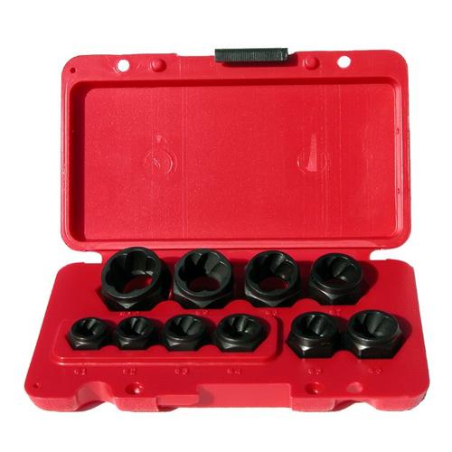

    Impact screw driver or small bolt extractors does trick for me. The screws are 1/4-20, so I usually replace with stainless hex head bolts.

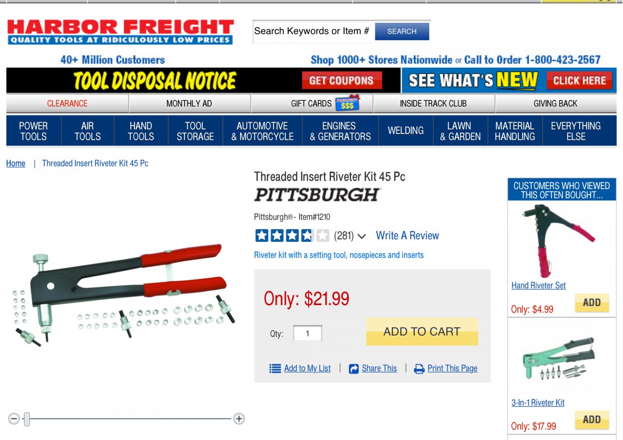

    If need be..
    Harbor freight to the rescue.
