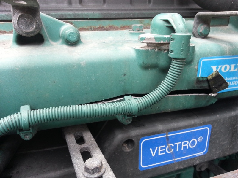

    i Have same problem from last month on my 06 volvo d12 465,lack of power, no jake brake, poor fuel milage,i couldn't finds the problem..yesterday i found the big crack under the turbo boost sensor(may be its was small before) i changed the intake manifold($ 147.48from volvo) now its run great.. IMG_20130422_104328.jpg

    I found a large leak the hose between intake manifold and CAC. I took the coupler off the turbo and connected a home made pressure tester and charged up the intake with air. Air came rushing out of hose that wasn't on the hole way. Fix that then found CAC leaking. Replaced that and now last 30 day Mpg's 6.78. The month of Nov 5.75 average. Never even hit 6. 2007 Volvo 630 D12D
