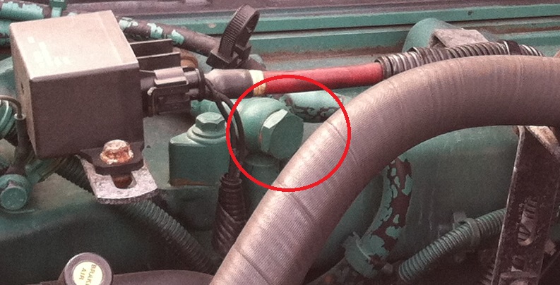

    its called a hollow screw, its located on the intake manifold and holds a return line to a distribution block. part number 3095479 and 2 gaskets 11996 it overflow valve.JPG will cost you about $50.00. sorry picture wont upload. but its just behind the alternator, on the intake manifold the bolt end is 7/8 inch.

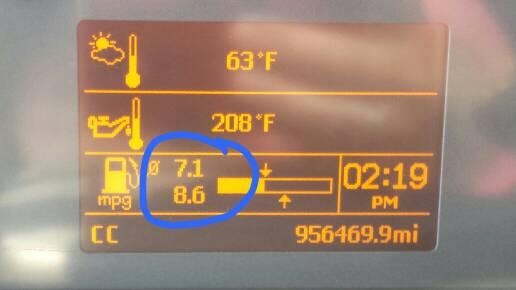

    image.jpg We'll, I've replaced both egr valves, the exhaust manifold, turbo, had the overhead run, replaced both fuel filters water separator and secondary, spent hours in volvo, trying to find out why I was getting 5.5 MPG, and nothing. Had the cylinders balanced, replaced sensors, have 100 psi on my fuel pump, and still nothing, after spending hours climbing over everything I can read about the fuel system, since my boost pressure is most of the time 30 psi or above pulling a long hill but turbo outlet temperature had fallen to below 600 deg, I found a mention about the overflow valve and that it controlled the fuel pressure on the last injector maintains 50 psi there, if it leaked the injectors would not get proper fuel supply. I changed it.

    That's more like it (7.1 MPG) Glad you found the problem
