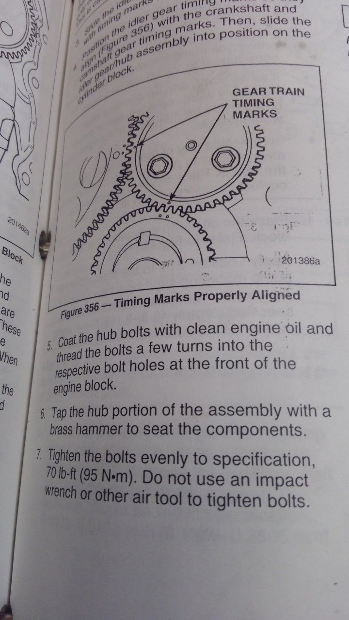

Update:
So yes check your H rings. Ring on five intake was loose. Looking down the tube looked fine, but double checked pushing an extension up through the bottom on all of them and it slid right up. Rear head got taken off and new oversized ring installed.
Currently going through the reassembly. And overhead is looking way better than before.Attached Files:
