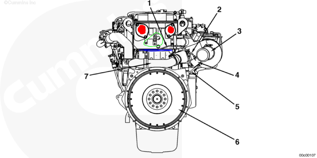

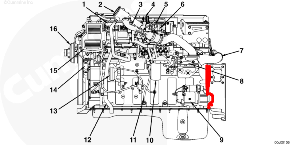

Hi professional thank you very much for those details, they are life saver. You were right there are holes but no filter after changing the blowby tube leakage has gone away but it drips few drops from blowby tube that's the only issue for now injectors are fine, next step told by mechanic to take oil samples and get them checked.

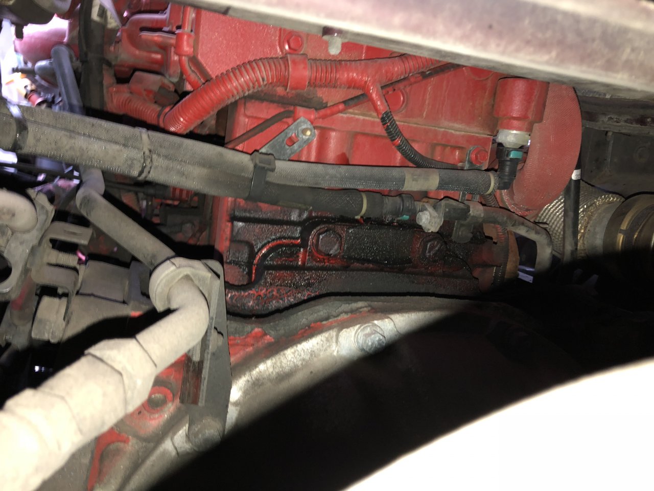

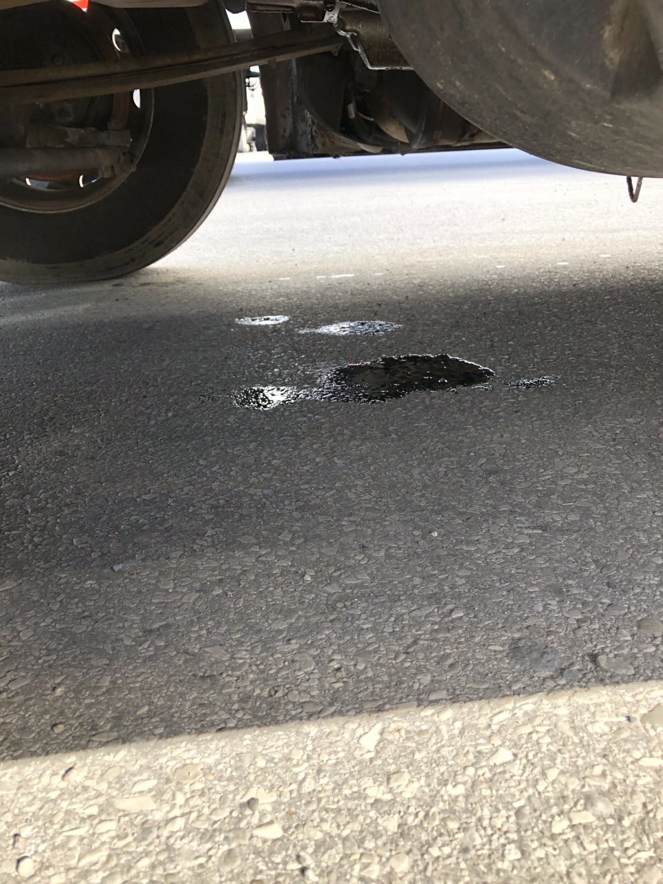

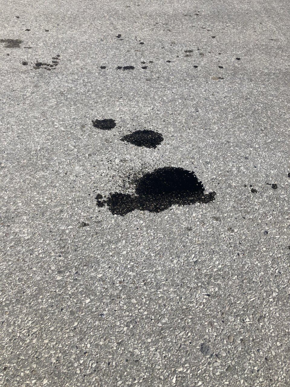

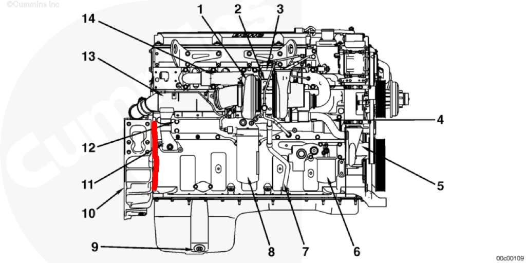

I bought truck with 2012 Volvo VNL isx15 ,540 k miles .it's leaking oil from the rear just started today and leaking . Any suggestions?
, it's leaking oil from the rear just started today and leaking . Any suggestions?
Rear main seal probably that stays between engine and the transmission. If it’s not that bad you can drive for sometime if money are issue, but make sure u check the oil dialy since they can get bad in no time also. While u there is good to have replace your clutch and idk if it’s volvo but if it is while there is good to replace also the both motor mounts.

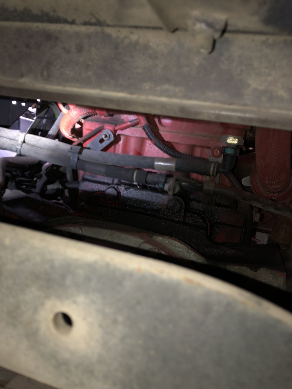

I have a 2016 680 with the 2013 model isx13. I have an oil leak in the rear of my engine. It's more on the right side,leaking down a little to the right of center,just behind oil pan.Looks like its under the trans. It's 2 distinct drips in a parallel line, not side by side. I thought it might be the rear main seal. I've also got oil gathered on the top of the bellhousing. I can see it clearly just below where the egr cooler wraps around the rear of the engine. Any help is appreciated.
