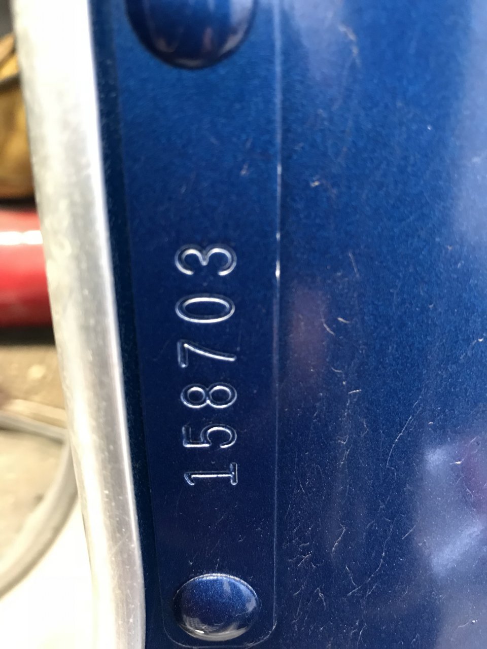

Post last six of VIN. 07 might use turn stalk module.
Yea that’s what I’m afraid of. Any information you can help with would be wonderful. Thanks
