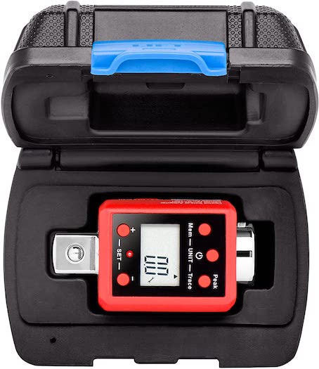

    this is the same specs i saw and mine has the 5/8's cone with a steel flange so i figured 200 ft lbs. i used a cheater bar on my 3/4"drive ratchet,, i guess my question is are the old school guys just doing it with a cheater bar by "feel" i mean,, when i change a tire on my truck i reallly don't use a torque wrench,, just the usual "good n tight" philosophy

    pretty nice tool thanks for the info!
