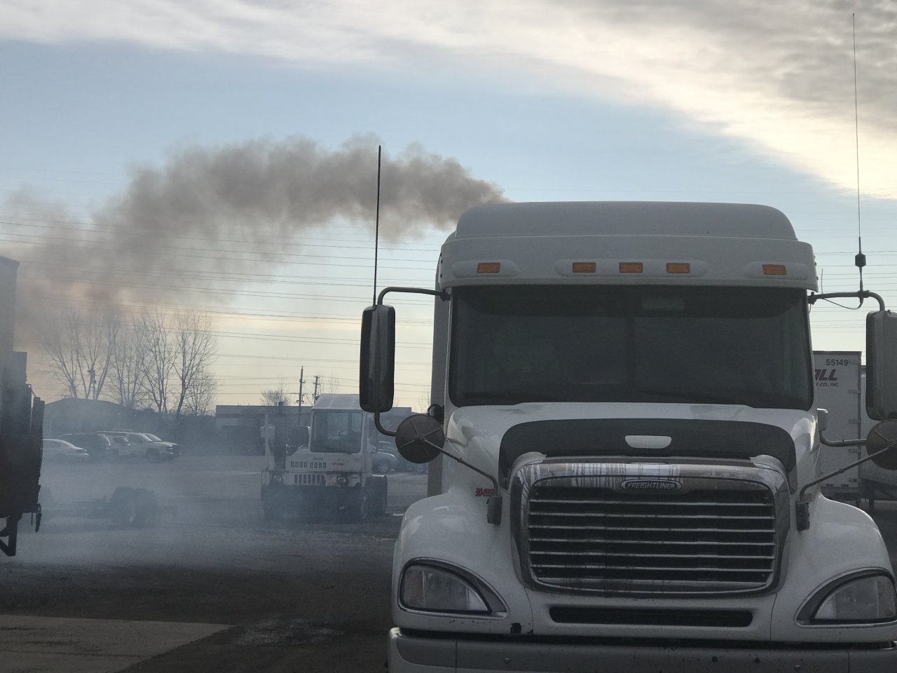

    You cam have the cold settings changed in the e.c.m. so you don't have the smoke when cold.

    I didn't even know that was a option. I'll look into it thanks.

    When you say "changed" what does that mean? Set it up so it uses less fuel at lower temp? I was told by a Detroit mechanic last year it might be a cold temp sensor too...or maybe he said air sensor...I don't recall. I didn't mess with it, not yet at least. That is further down on my laundry list of things to do!!!
