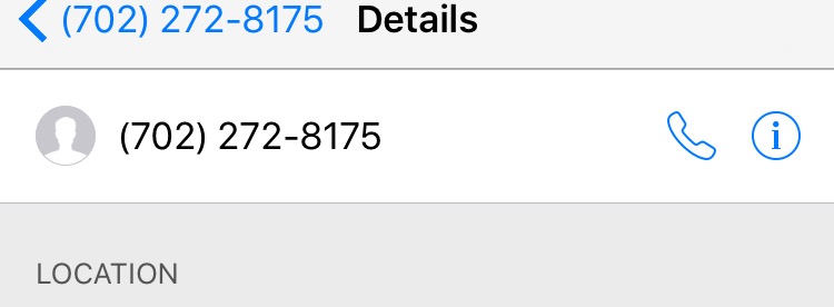

    I actually found a guy in las Vegas who was close to me and he sent me a brand new set of flowed and balanced 5915's. His core was only $50 a injector. It's a deal I couldn't pass up. Here's his number give him a call. image.jpeg
