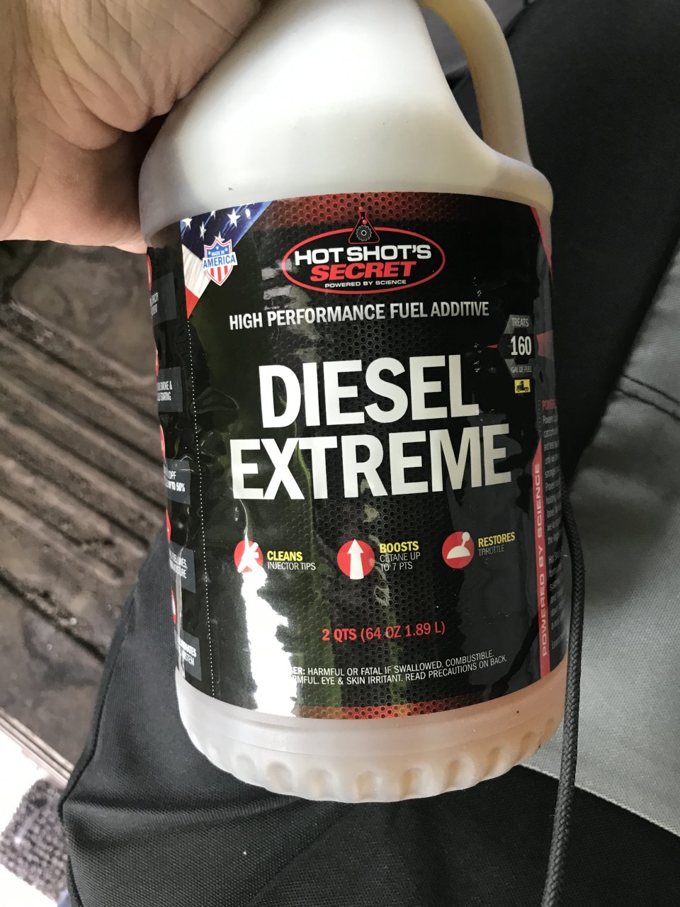

    Skip the injector cleaning BS. Run 2 quarts of atf in each tank when you fill up or try this before you spend all the money. It's like $30/gal and I used one for each tank. A06951B8-0396-4C5C-A2DC-31944791F6A5.jpeg
