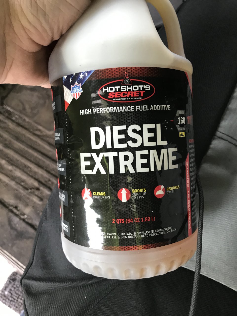

    Thanks for all the info, I will try the additive!
