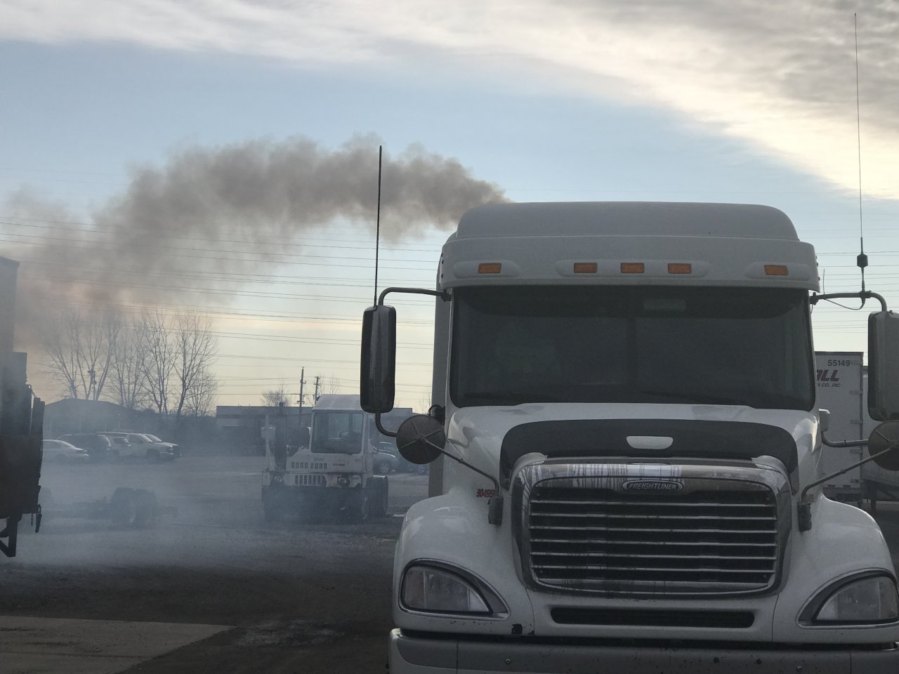

On another note, anyone else's 12.7 smoke like a mofo when it's under 30°? It clears up after it warms up. My mechanic keeps saying is normal for a 97 motor.

Only white/gray smoke until warm...a bit of blue smoke then until hot.Vampire, jamespmack and ChicagoJohn Thank this.

Lots of fuel smoke on startup is generally because it’s cold n you have excess fuel washing your cylinders when they’re cold in my experience.DetroitDudeBro, Vampire, jamespmack and 2 others Thank this. -
