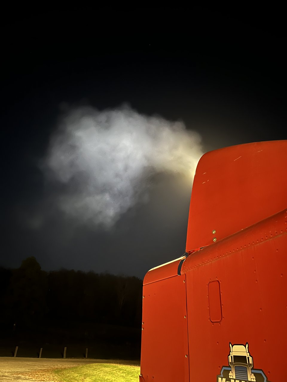

    I did the water bottle thing just at idle. The darn bottle moves towards the windshield. SMH. Got a lot of smoke too. 3500 miles since rebuild.

    Smoke looks white. Maybe from street lights? Is it white or blue? Does it ever go away? Maybe fuel line is sucking air. Look for bubbles in fuel tanks while it’s running.

    Just an opinion but I will bet it’s either out of time or ambient air temp sensor is reading colder than actual temp.
    How does it start?
