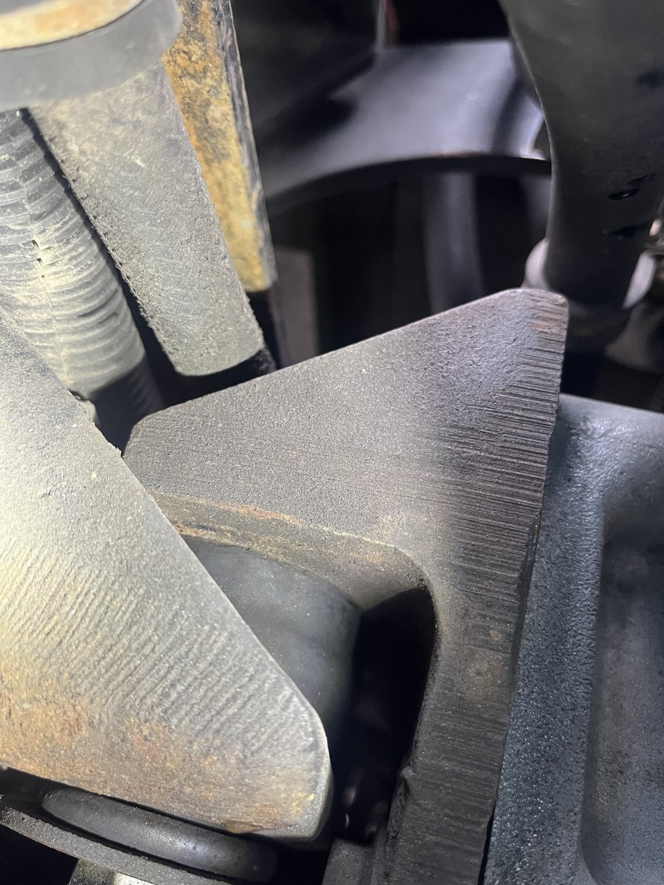

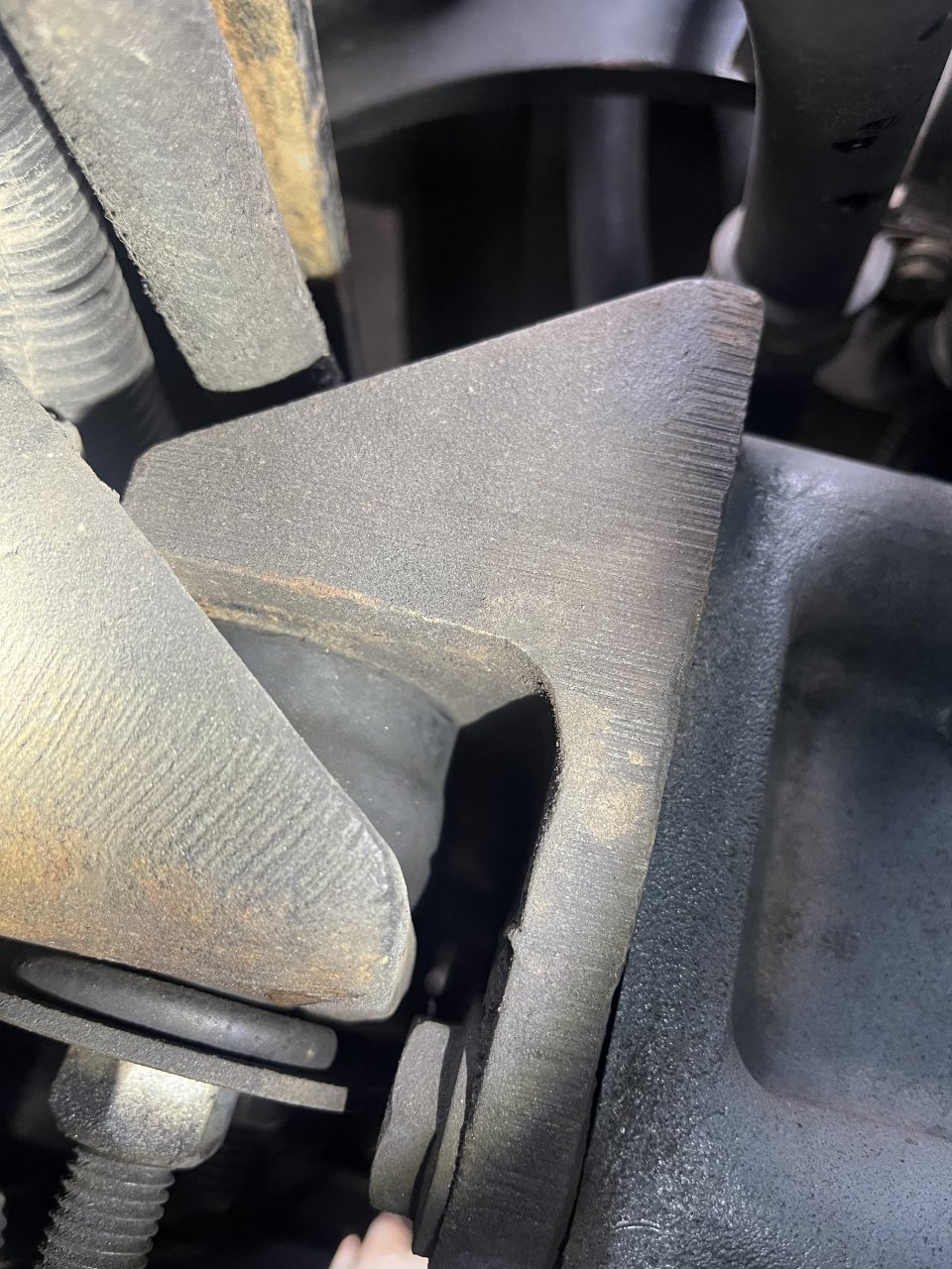

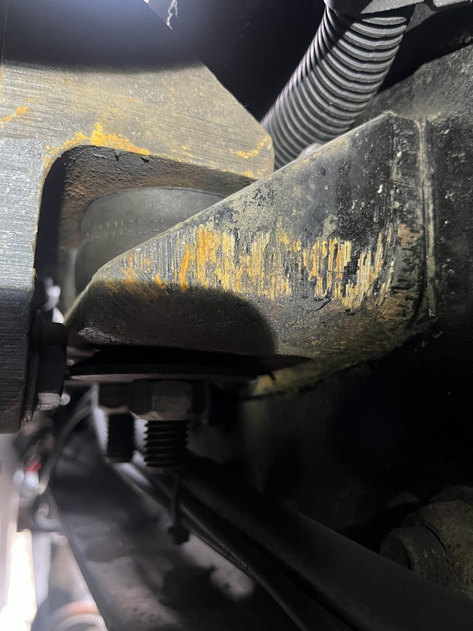

    1FF1CD0C-D8A6-4610-8210-C31A2736B6E8.jpeg A2F61CFF-A93E-4759-96CB-2304C22679C4.jpeg DBCC19A5-4448-452C-A7E6-1880510C8220.jpeg Here are some pics of the motor mounts. Not sure if they are good enough or not. I can try for better ones if necessary.

    The original motor did sit lower in the rear. This one looks like it sits much lower. Are the motor mounts installed wrong? I can’t find anything online showing pics of the assembly or diagrams. I will ask my Freightliner parts girl on Monday.
  7. Dave_in_AZ
    59,250
    410,937
    Don't know if they're the wrong one's or anything about the shim process, but they are definitely new.

  8. JoeyJunk
    JoeyJunk Road Train Member
    8,762
    68,030
    Dec 31, 2010
    Washington, PA
    Yea I knew that as I bought them. Shims were never mentioned by anyone at the dealer or the shop. I didn’t pay any attention to the old mounts as I assumed these jagoffs were legit in the beginning. I may go to the junkyard Monday and see what those ones look like…..unless I can get some answers before then.
