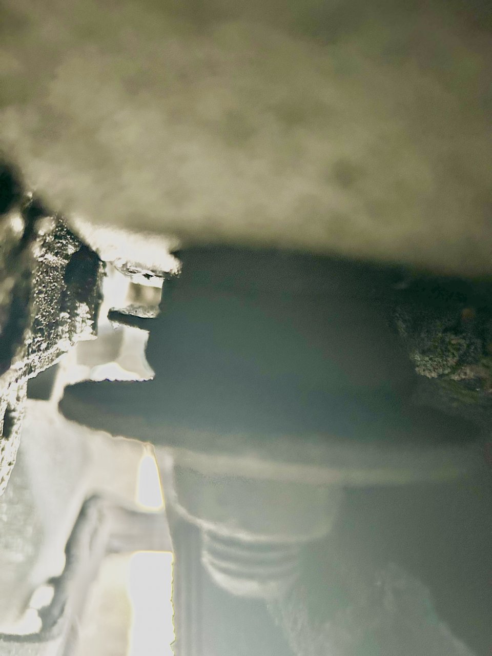

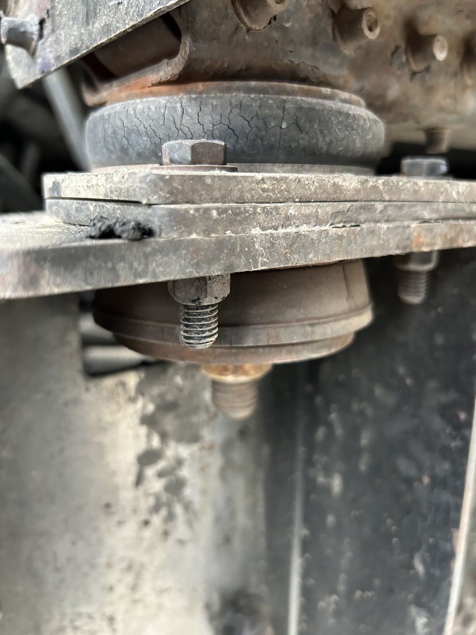

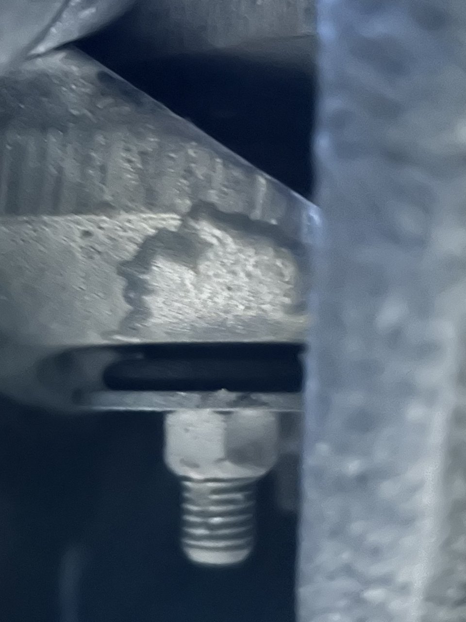

    0D7840BD-02CE-4170-9059-456DBB8344D8.jpeg EEE2AB8F-E784-4577-9D90-3D4A38FFDBAC.jpeg 8C437EB4-899D-44DD-9C38-9C11DF04A8BD.jpeg So I took pictures of mine. Looks like some idiot ( Me ) left the Drivers side MM loose. I’ve been meaning to check it, Been feeling movement of shifter when starting from a stop, thought maybe the oil leak ruined it. Motor mounts are 3 yrs. old. It’s good just loose. When they’re wore out, there’s usually a gap on bottom between washer and frame. You can easily feel it and move it. Same goes for the cab mounts. Any slop I’d space on the bottom, they’re wore out.
    Dino soar, austinmike and JoeyJunk Thank this.

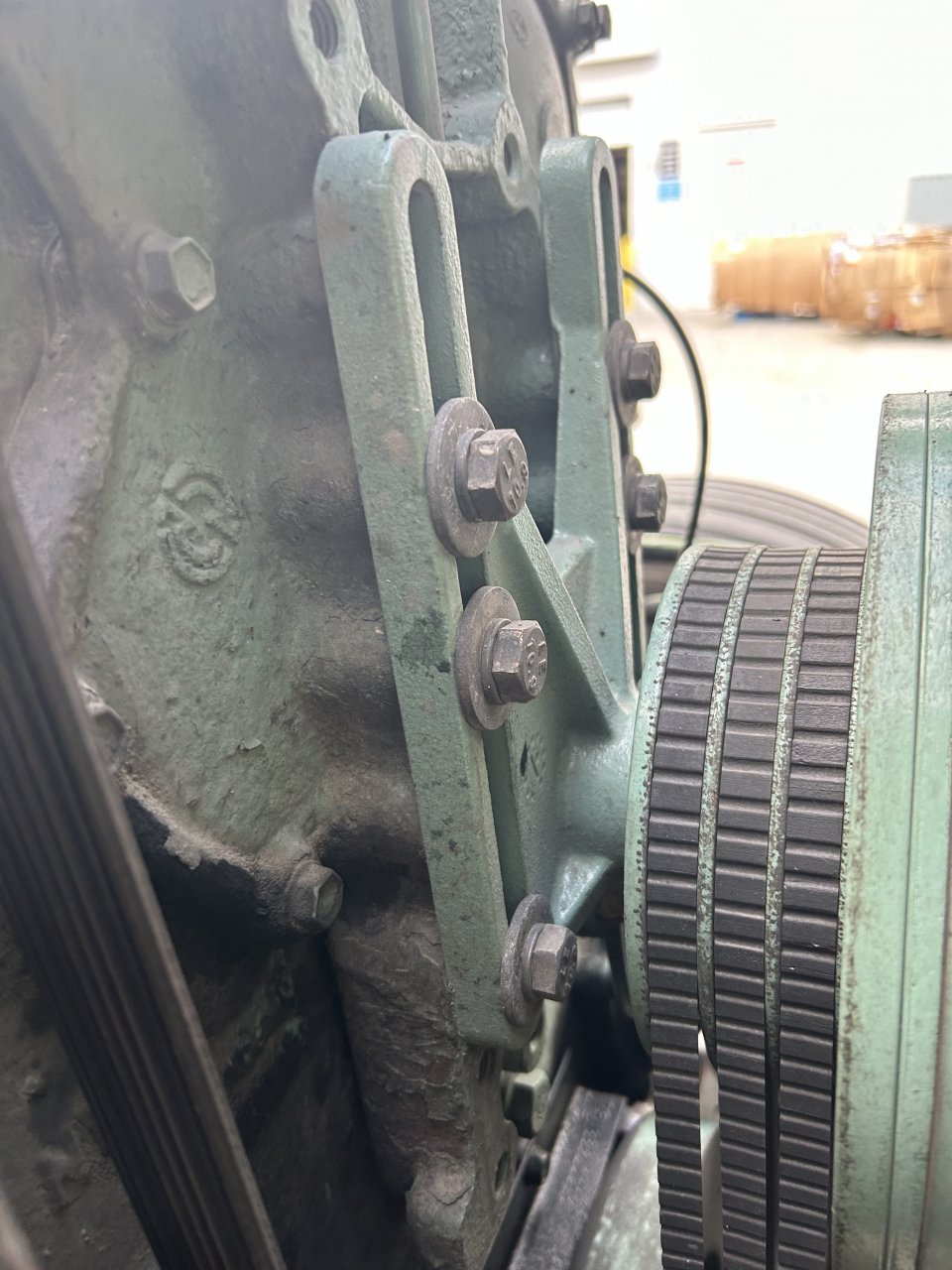

    954D6B53-DB6B-48F1-AC30-7710A465B57B.jpeg My fan did come completely off once. So did the whole a/c bracket once. Both times no damage. Here’s my fan now with new (used) front inner and outer covers. Bolt holes are still good. Been staying tight. I check the ac bracket bolts regularly. Once they get loose, it starts rocking, wallows holes and snaps bolts. Fan needs 6 bolts, preferably in these locations. They need to be real tight.
    D.Tibbitt, austinmike and JoeyJunk Thank this.
