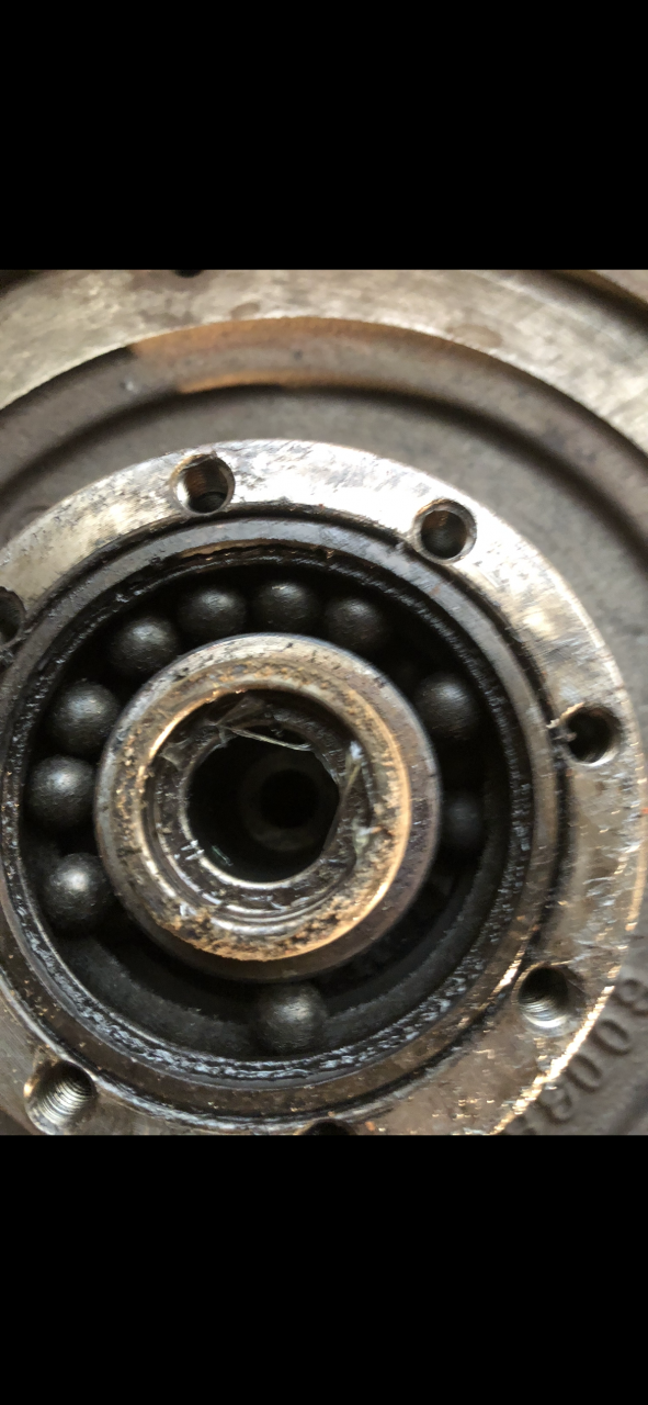

    686E9617-D687-4051-A8F6-48C2E7C0245F.png That fans a brand new Kitmasters reman fan. Here’s my old fan. I rebuilt it less than 2 yrs ago with a Kitmasters kit. They’re supposed to reimburse me the cost of the kit, and give me partial credit on my core. They said they’ve never seen this happen before. Bearing and race are all jammed up, I followed the instructions. Properly torqued everything.

    My fan bolts were not really tight. Now I feel Like I need to go around and tighten EVERYTHING.
