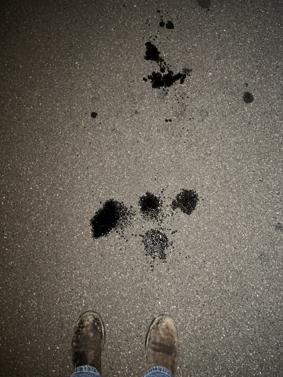

    Washington, PA
    This is what idling for 3 hours leaves behind.
