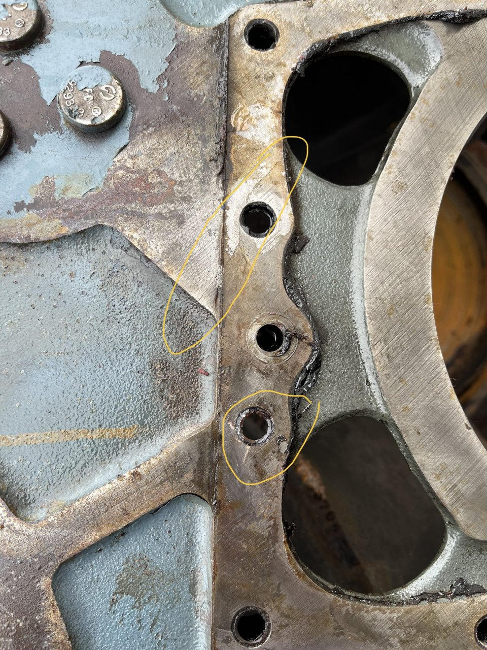

    Here are the cracks in the front cover.

    They ran the overhead and checked everything else. They asked if I changed front motor mounts. Of course I did. Then asked if it was aftermarket. Nope, Freightliner. Said it was soft, almost spongy but looked new. Very strange. I forgot to ask to see it. Maybe that was the issue all along? Factory defect? Bad rubber? Did they react to a certain fluid and start to break down?

    Here are some other things they found.
    - No glue on the cam caps
    - oil pan wasnt sealed. Old bolts and sleeves were used.
    - front seal leak. Crank was damaged with prying device
    -old style rocker tappets were used

    - Rocker cover had multiple cracks. Wrong gasket was used and it was damaged.
    - bolt missing from front cover
