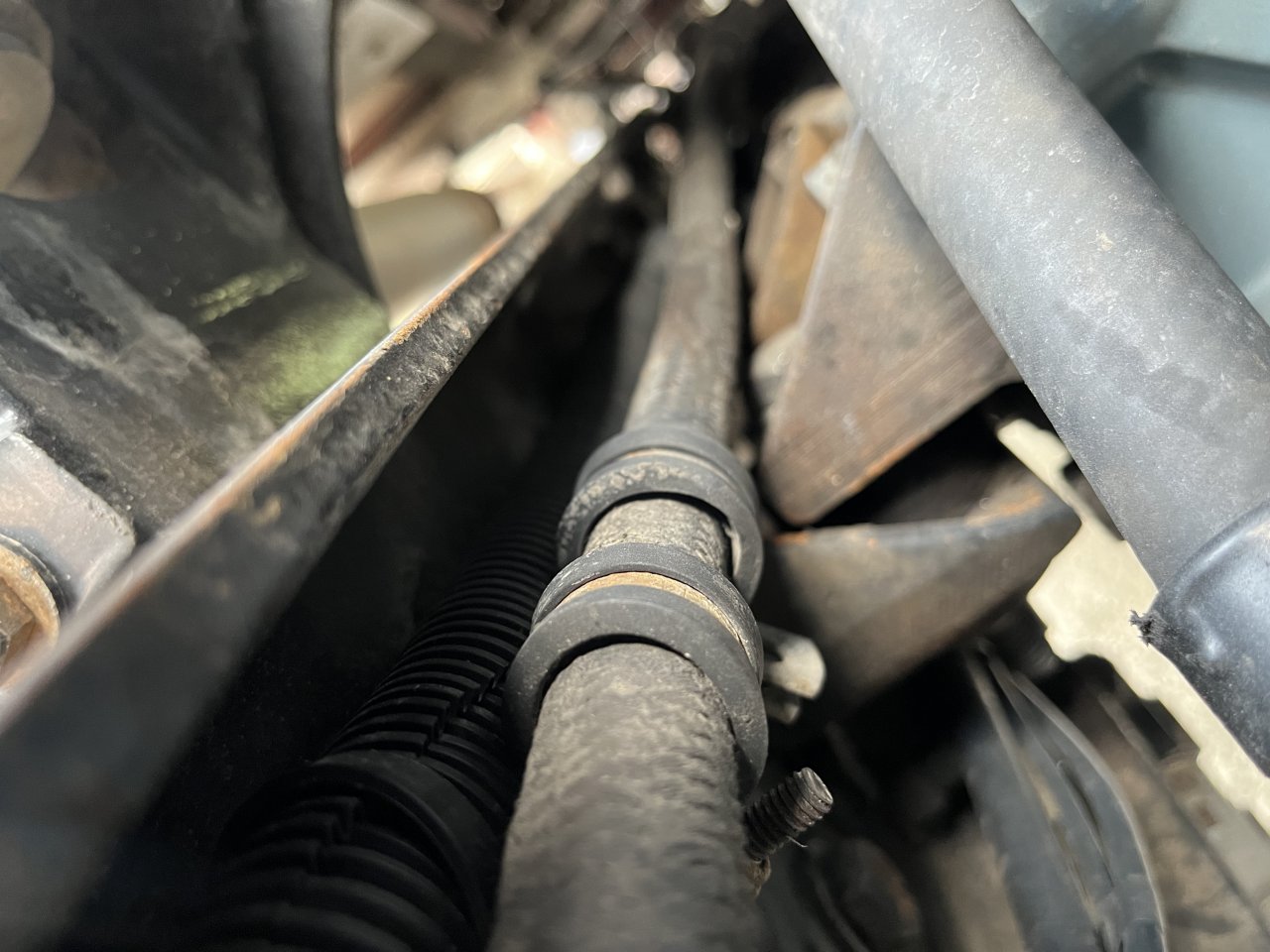

    Got a late start today. Haven’t crawled under yet but I was looking at motor mounts and from where I can see, it looks like the wrong ones were installed. If this is the case I got questions.
    1. Where the eff are the new ones I purchased?! There weren’t given back to me. And if they were I would have noticed this issue immediately.
    2. What mounts are installed incorrectly? I provided all new mounts. Were this not installed somewhere else or did parts girl give me extra and they just used them. (None of them were in labled bags.
    3. WHY CANT YOUR IDIOT EMPLOYEES PUT THINGS BACK THE WAY THEY CAME OFF??????!!!!!!!!! Have the same guy take off and put on that way the reetard might remember.

  11. JoeyJunk
    JoeyJunk Road Train Member
    8,762
    68,030
    Dec 31, 2010
    Washington, PA
    This is best I can do until I get home and get on creeper. AD0E7C3A-7868-4B16-8183-00198D3BB6B1.jpeg
