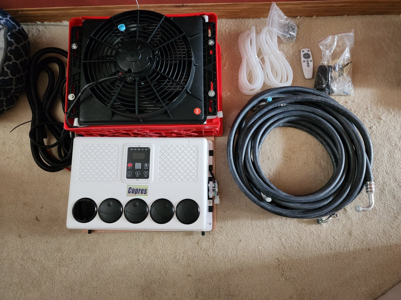

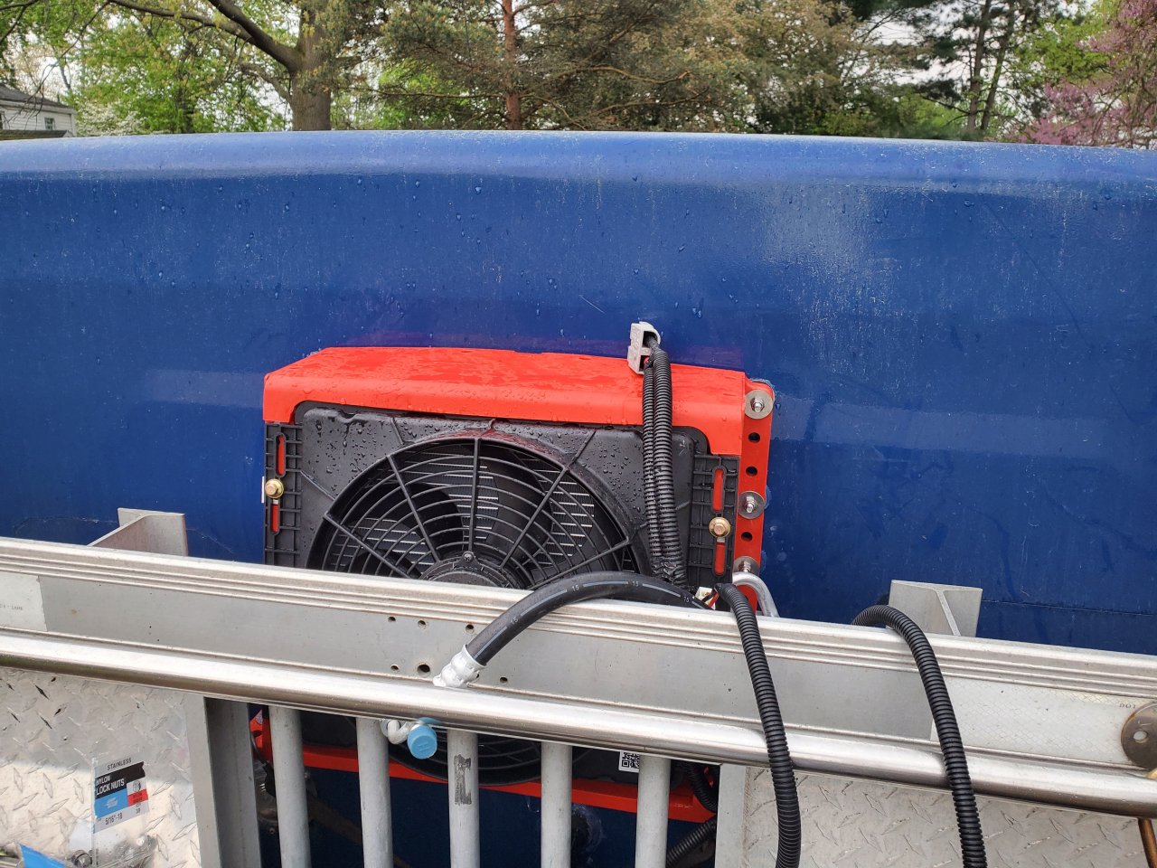

    It seems to have 0 parasitic draw, but because i plan on a lifepo battery bank and dont have an isolated starter battery, i have not yet tested its full draw with truck off yet. On a 3 battery setup, it does 45 minutes no problem
    I did rest the outdoor unit on the horizontal bar behind the sleeper and just made up some diy ubolts but also put some rubber padding on that.
    It does okay coolingwise, its in a tiny t800 and with truck running i tend to use it as my sole ac on the assumption that alternater parasitic draw is less of a hp theif than the ac, plus, its an old kw with the old ac box, so it wouldnt be doing much anyway

    You've yet to run your evaporation lines.
    I have a Carrier APU but the 110V is $2,000 just in parts and the A/C is another $2,000 and then there's shop charges to get to the professionals to install.
    I can get it to run just to keep the main engine warm and to recharge batteries with its 65A alternator. I'm counting on that being enough to keep the batteries up to the task. If not, I have an old APU alt I'll get rewound to 85A. From what I've read, I'm confident one of both configurations will be sufficient.

    That pic was from installation, i definitely ran the lines and charged it since then, if we had teleportable refrigerant, pretty sure that would open up a lot of alternate ways of cooling, not to mention making transportation companies somewhat obsolete.

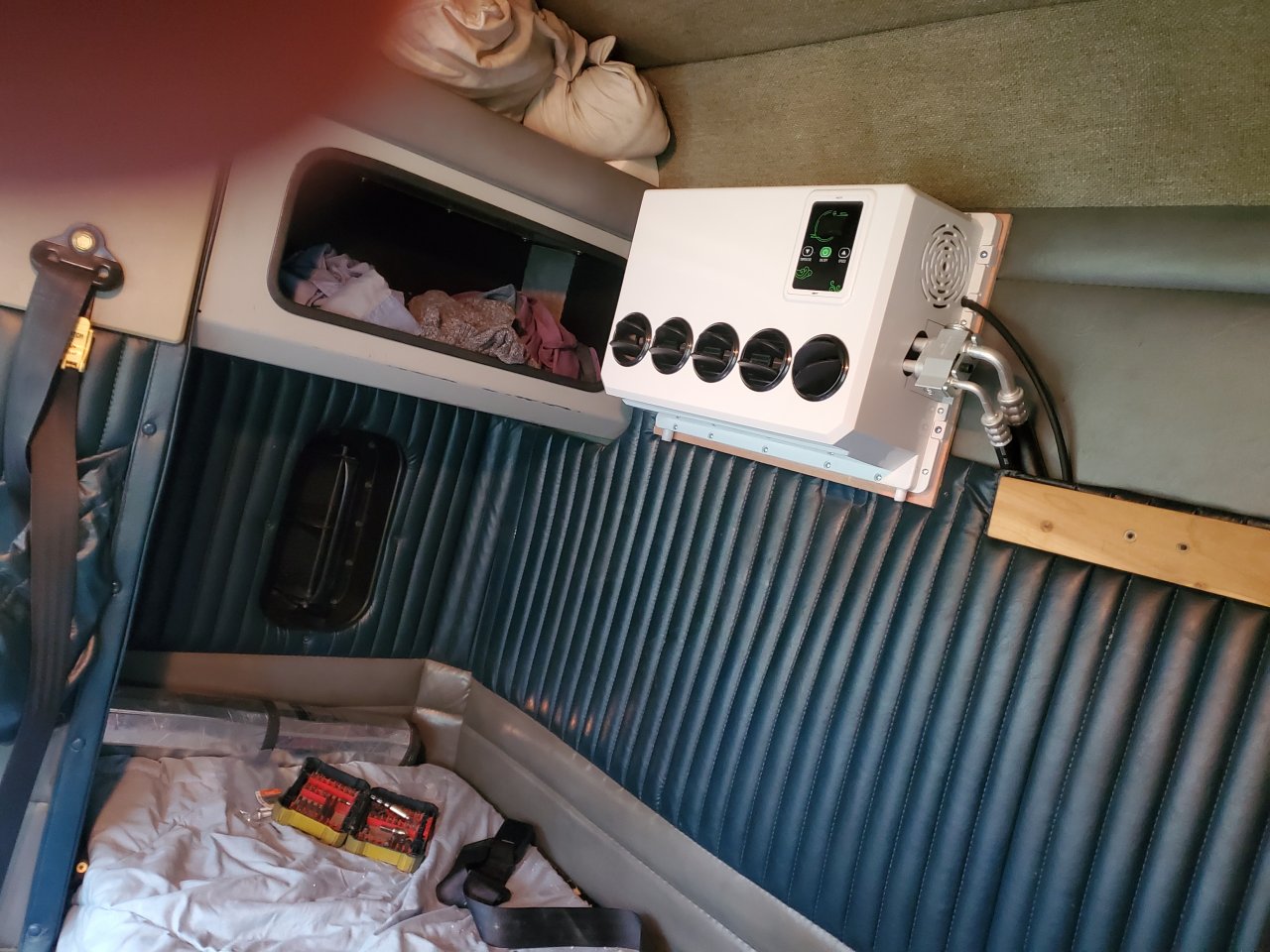

    20230715_153508.jpg 20230715_153623.jpg 20230719_162132.jpg Finally did my install. As the cap of the truck was fiberglass, installing on the back wall was out of the question. The suggestion of running two aluminum angles across the fairings was proposed but in the end I decided to put the compressor assembly on an isolation pad with four heavy bolts into the top of the chain cabinet. I had 6m refrigerant lines which were perfect to go down, under the cab, and up into the sleeper's cupboards. As I wasn't installing the internal unit on the back wall but above the passenger side cupboards this proved efficient. I ran my powerlines straight down the chain rack and into the APU assembly where I tapped into the starters power lines. The controller harness I had to lengthen. It's quite gentle on the batteries but until I get the APU starting again to charge the batteries, I find I have to start the truck at least once a night and run it for an hour.
