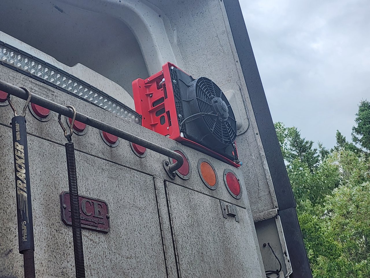

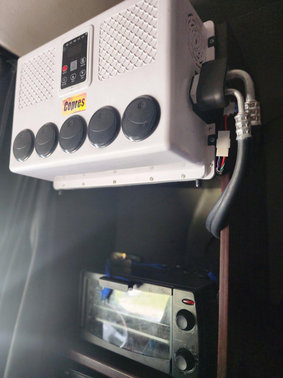

    Mounting to the chain rack is preferable anyway, vibration directly on the back of the cab when it cycles is quite the annoyance. (My headache rack is an unenclosed chain only rack, sorta wish id put it down bellow the rack or mounted to backside of chainrack)
    Thats virtually the same model i have, be curious what amount of refrigerant you used. Pretty sure i slightly overfilled at the 600 grams they say (22 oz.)
    the high/low readings dont seem to be good indicators for as high as im used to on other ac systems.

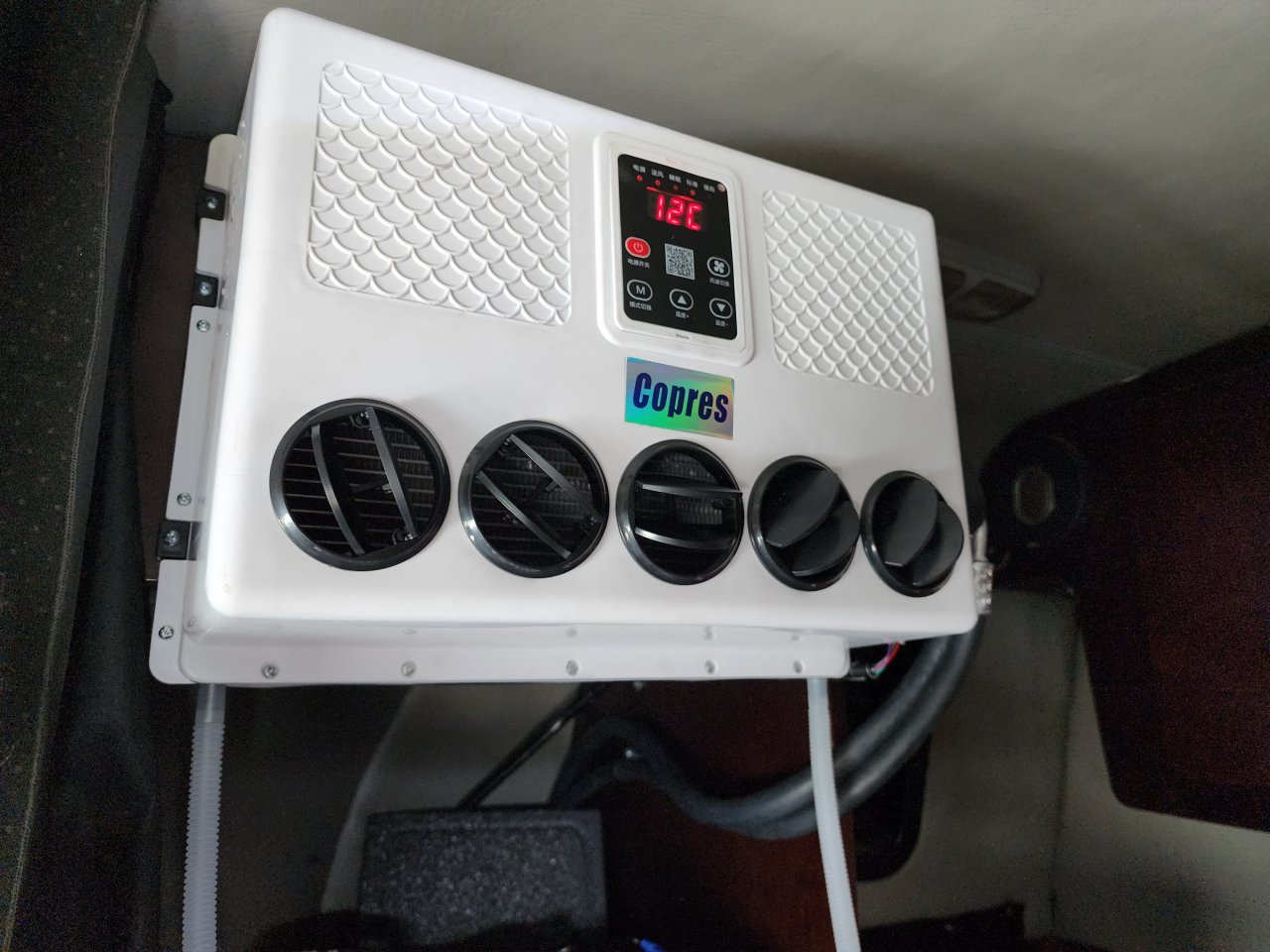

    I bought my truck with a Nite system under the bunk. Guessing it was installed around 2008, so I didn't even expect it to work, but I got 4 years out of it until recently the compressor fails to come on. Haven't had a chance to take a look, but parts availability seems to be non-existant. I've looked at those little mini splits and was wondering for the guys with the setup, is there any condensation issues with the low pressure line? Something about having them exposed just seems like it would create a moisture issue.
  4. skallagrime
    skallagrime Road Train Member
    3,856
    9,934
    Apr 10, 2012
    Indiana
    Outside, it doesnt matter, inside, there can be SOME on the insulated (rubber) hose, but really only in excessive humidity situations,best to simply leave them exposed so you can wipe it off if they stay wet, if you wrap it, that can create a place for mold to grow and you wont see it till far later than you want

    I’ve had mine installed and running for the past 3 weeks and have not experienced any moisture issues just yet. I’ve tested mine down in Texas 110F degree heat and worked perfectly for me. My AGM batteries are very weak currently, but I have the unit wired to them. My IdleSmart keeps them from dying completely and I have it set to run for 1 hour to get voltage back above 12.5v. At night and below 80f degrees, my truck starts maybe 3 times. I really don’t know because I’m asleep but IdleSmart keeps track of how many times my truck restarts and my reports say my truck is restarting 3 to 4 times a day. During 34 hour resets, my truck restarts about 12 times. Again, that’s because of my weak AGM’s and the fact that 1 hour charges isn’t enough to recharge them fully. That’s still good given that during a 34 hour reset, I’m using 12 gallons instead of 34 gallons of fuel.
    I’m going to install a 400ah LIfepo4 with DC to DC charger, upgrade my alternator to 300a, and eventually get solar panels installed for trickle charging. My goal is to reach only having my truck restart once in a 10 hour rest period and 2 to 3 times in a 34 hour reset. If Maxswell still made their module, I would get rid of AGM’s and run straight LIfepo4’s upgrading to 700ah to 1100ah. Until then, I’ll run 400ah lifepo4/400ah AGM’s totaling 800ah with possible upgrade to 1600ah (2x400ah run in parallel/400ah AGM’s) based upon further testing.
