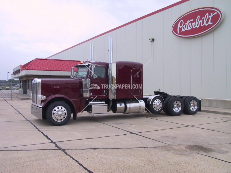

    C16 Cat is great but not necessary. In my book, ideal specs for heavy haul would be:
    1998-2003 truck
    3406E, C-15, C-16 cat, 14.0L detroit (PRE EGR, Rare, but a beast). 600HP+. Pre-low nox configurations recomended. If not available then custom tuning by PDI highly recommended
    18 speed transmission. 13 okay if gross is less than 150,000
    3.90-4.11 differential ratio (single speed rears, the double speed rears are unreliable, get an auxillary tranny instead if you need it)
    24.5 tires to keep rpms in line
    double frame (to the front axle not just to the rear of the cab)
    14k steers with 385 tires
    46k rears
    20k pusher axle
    260" wheelbase (much longer and you'll start running into a second escort on a 13 axle, shorter you won't have enough spacings)
    A loaded 13 axle is a superload in most states. You definitely do not want to use a normal road tractor for these applications.

    I think you are getting in way over your head...
    Most of the quoted allowable steering weights listed in this thread are wrong.
    A 13axle is not the unit to start on in heavy haul. If you even think or have to ask if that first post's photo of a freight truck is ideal to pull anything over 150,000...I'd advise getting more experience.
