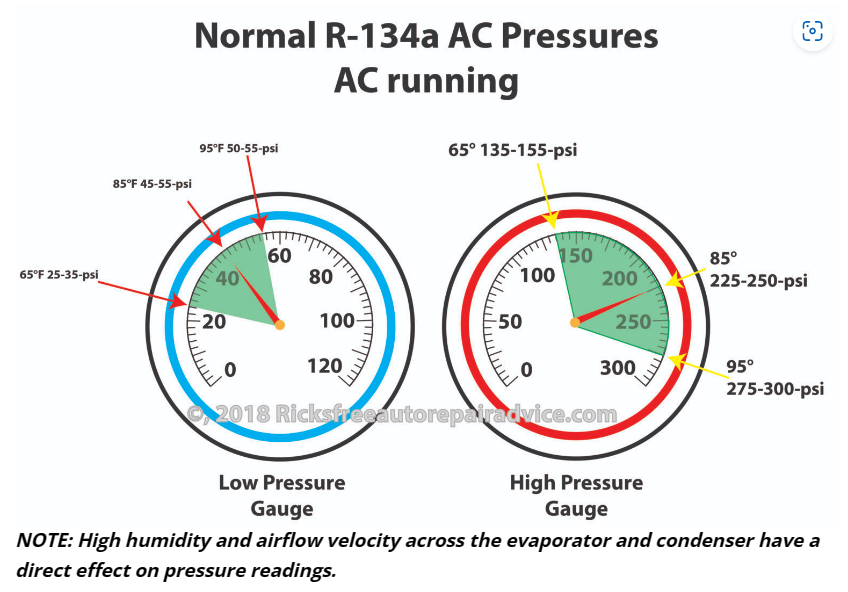

    Low side should be around 35 and high over 200. Make sure you use the correct refrigerant. Make sure the compressor clutch is engaging. The part with the pulley and belt always turns. The clutch is between the pulley and compressor. Given your pressures being about the same it sounds like the compressor clutch is not engaging.

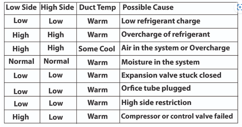

    Symptoms of a bad AC compressor
    • Low and high side pressures are about the same (like 80-psi low side and 80-psi high side) AND you have to increase RPM quite a bit to get pressures into the normal range AND you notice the air only gets cold when you’re driving AND you’ve ruled out a low refrigerant charge or bad orifice tube/expansion valve.

    Just wanted to update. I didn’t want to risk doing the job more than once so I went ahead and replaced the dryer and compressor vacuumed and filled it up. Ac blew cold after. I’m not sure what was the culprit. I’m pretty sure it was the dryer because the compressor did engage. I’m just glad it’s all working now. Thanks for your help and your diagrams they gave me a better understanding.
    JB7 Thanks this.
