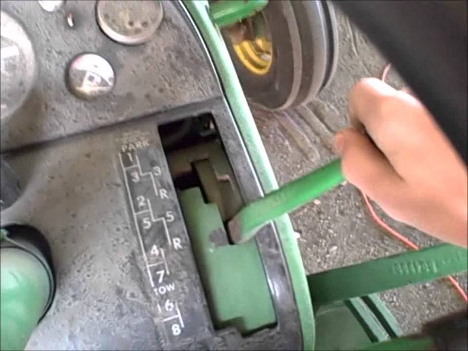

    Always made me think of the old Deere's with the shifter up by the wheel, They were almost that bad.
  8. johndeere4020
    8,522
    119,294
    Jan 1, 2010
    Easy now I can shift that with my eyes closed,
    MACK E-6 and Hammer166 Thank this.
