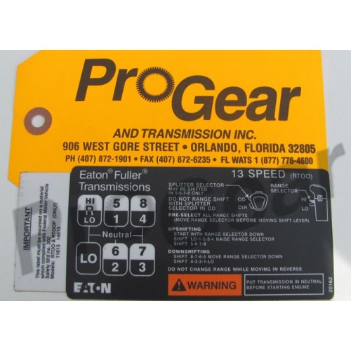

    Your math is a little off. You have a low or 1st gear on the low side (all the way left and down) giving you 5 gears and then 4 on the high side that can be split giving you 8 gears.... 8+5=13... LOL
    Just drive it with a "H" shift pattern and you can split the upper range.
