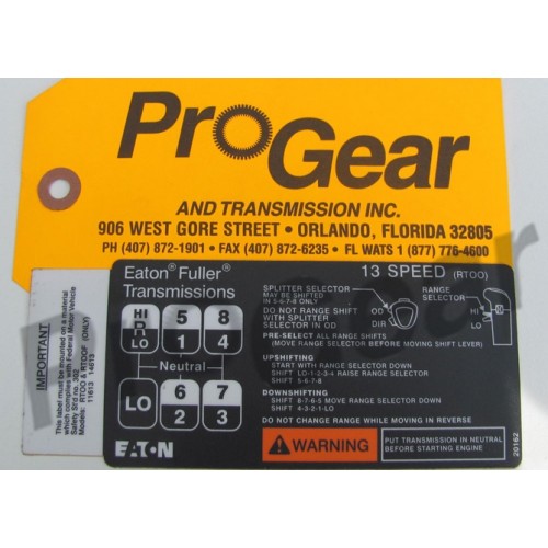

  1. Dave_in_AZ
    59,301
    411,414
    Did you see exactly what is the kit? It's not like he bolted on an extra gear box. Different shifter & airlines?
  3. AModelCat
    29,390
    161,299
    I've never done the conversion but I would imagine the transmission is probably a 13 speed but with a 9 speed shift knob on it. I'm sure I'll be corrected very shortly lol.
    wore out Thanks this.
  4. Lepton1
    Lepton1 Road Train Member
    12,647
    25,589
    Nov 23, 2012
    Yukon, OK
    The kit is basically a new air line and shift knob with the splitter under your thumb. You were correct in your previous post, that mega's buy "convertible 9's" so they can get better value when they sell the truck. They run them as 9's so newbies aren't overwhelmed, but serious buyers are looking for 13's.

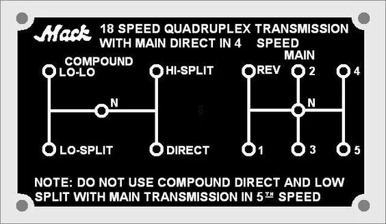

    Ah yes! Good old Quadraplex!
  6. MACK E-6
    49,635
    233,939
    Forgive my asking a stupid question of my own, but which way on the splitter switch equates to direct?

  9. street beater
    street beater Road Train Member
    4,578
    20,669
    Apr 18, 2014
    cold as hell, MN
    Ha! I told you boys a box pattern exsisted!
