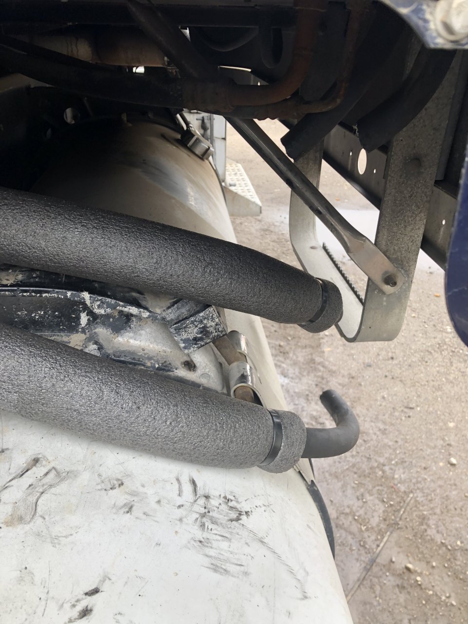

    8AD809F4-C27D-42C2-9A4B-3D9D94B39BFD.jpeg I wrapped mine with pipe insulation this time. Last time I used Armatex, Both available at Home Depot. Used 1” hose, over the 3/4” near the engine. No chafing that way. Leave some slack for movement of Cab/Bunk, and engine.on all ends, I tried to run some 3/4” soft copper lines, inside the frame rail, with hose on the ends only, but it was too hard. Hose all the way, as usual. Good for 4-5 yrs.
