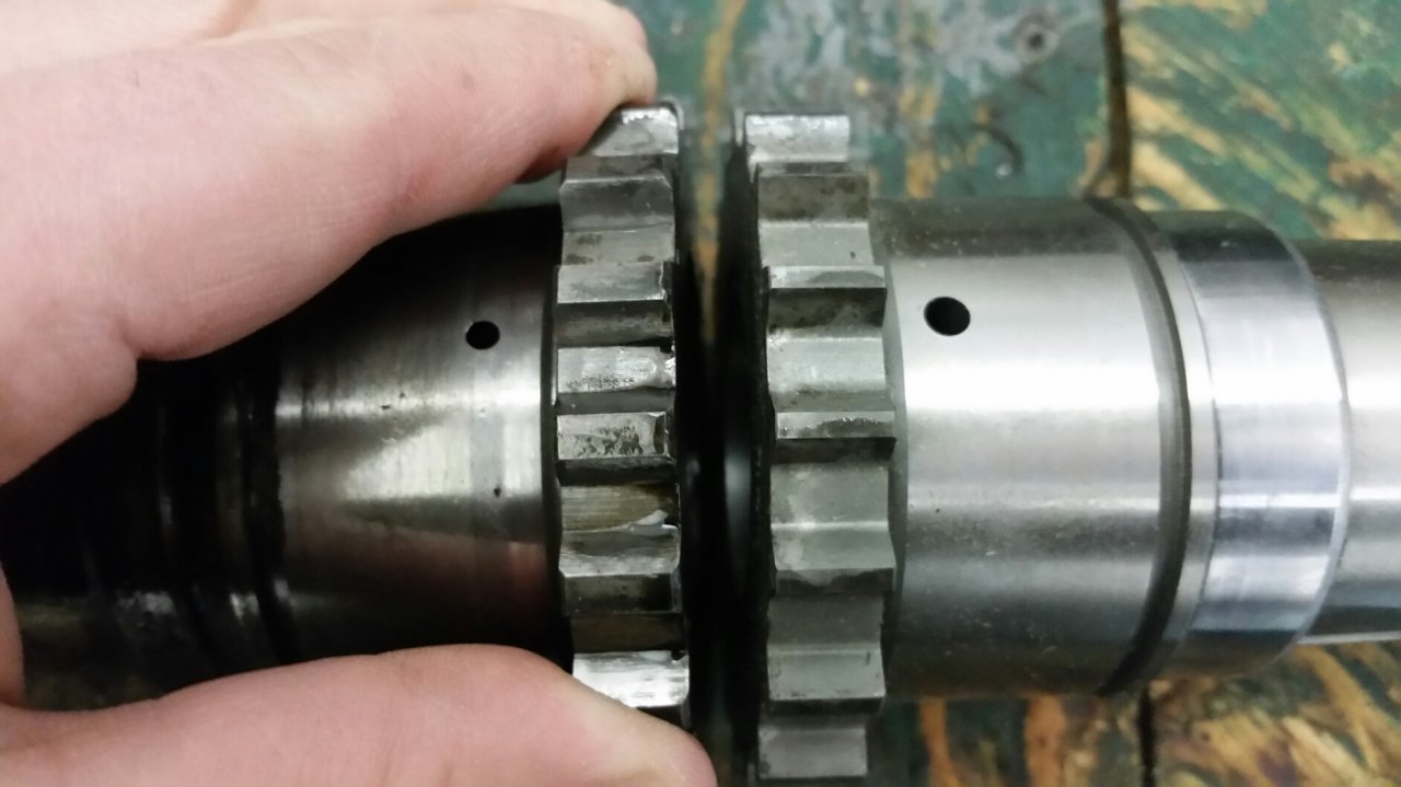

  10. AModelCat
    29,295
    160,417
    Old shaft left, new shaft on right.
    Oxbow, rank and snowman_w900 Thank this.
