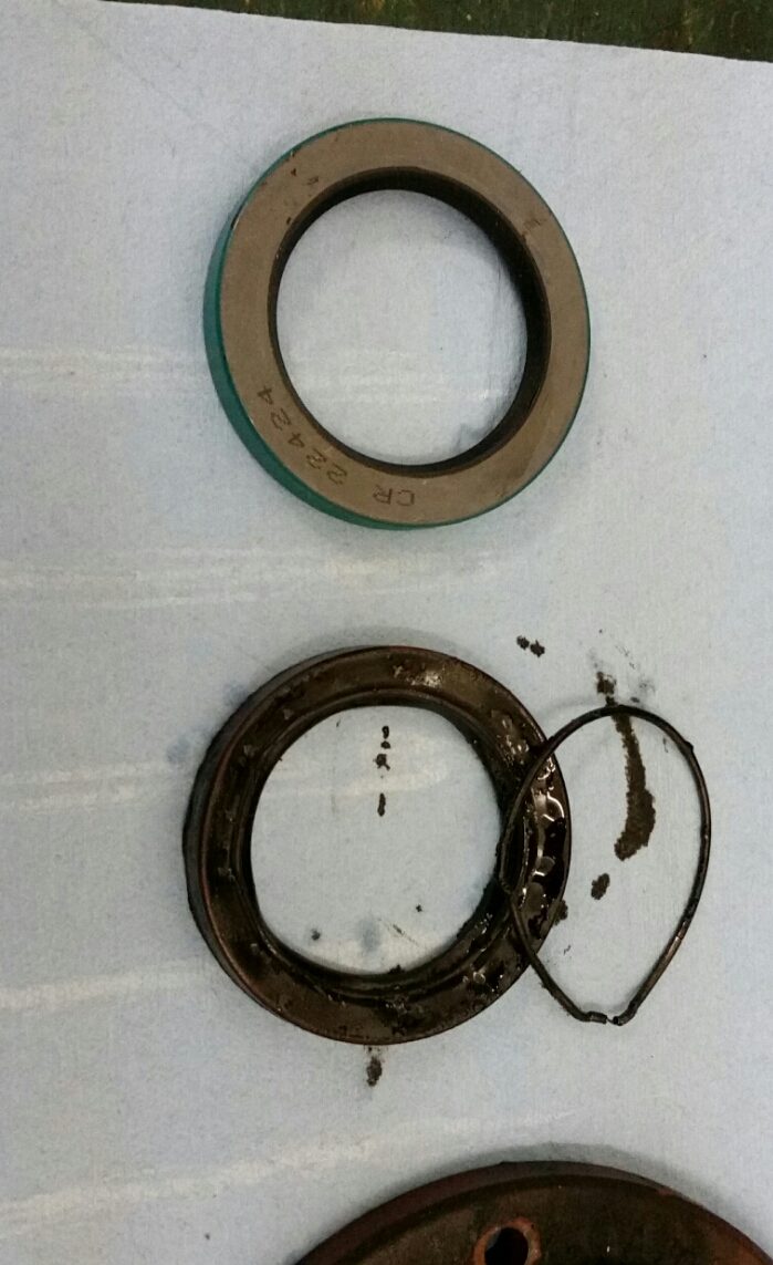

    So I have indeed confirmed that the input shaft on this particular 15 speed uses a lip seal. I will upload photos when the website gets its crap together and lets me upload photos off my phone.
    SAR and BoxCarKidd Thank this.
  3. AModelCat
    29,306
    160,502
    There we go!
    PN for the SKF aftermarket seal is 22424.

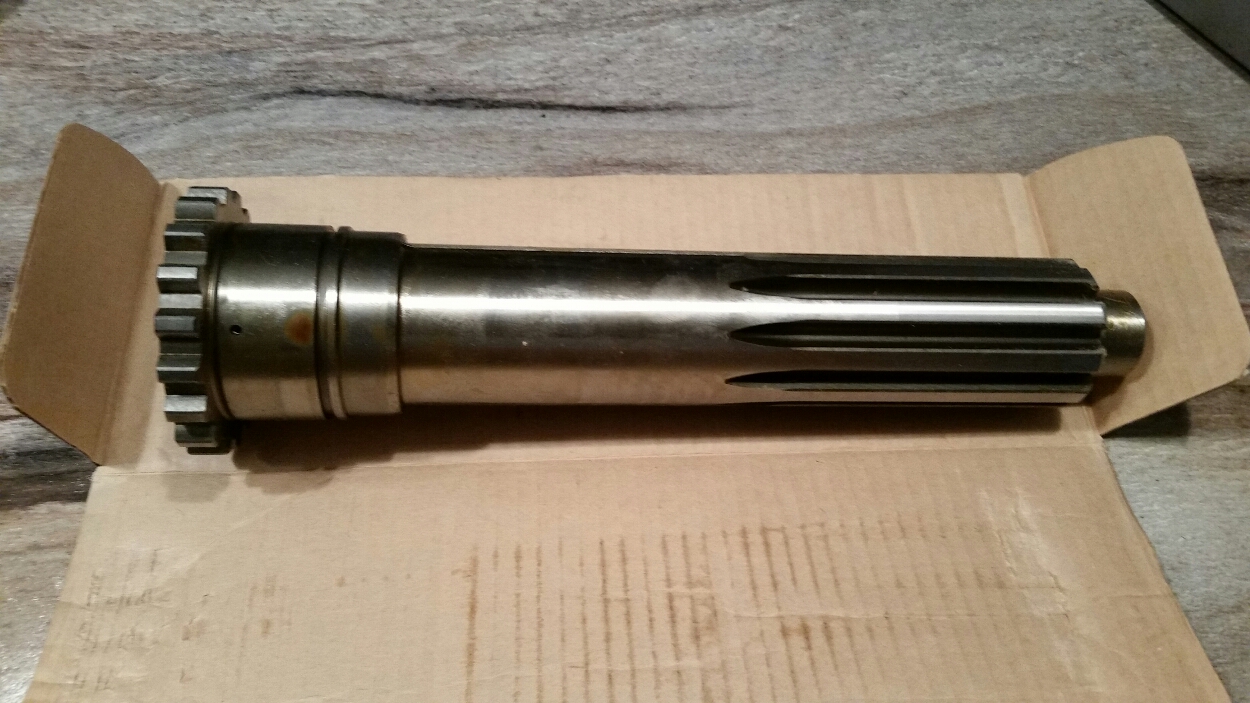

  11. AModelCat
    29,306
    160,502
    Well finally something goes right on this job! The teeth do indeed appear to be correct, as does the rest of the shaft. Yes that is my kitchen counter. I'm just that hardcore lol.
