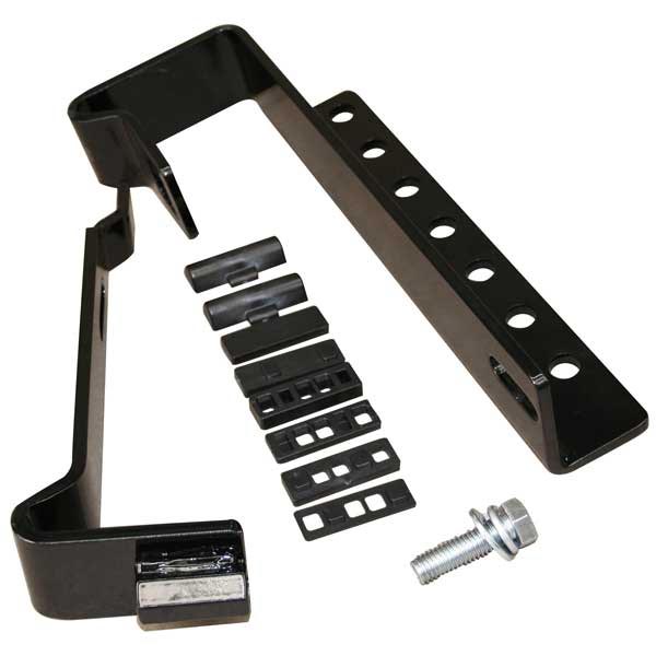

  6. Mike250rs
    Mike250rs Heavy Load Member
    881
    7,081
    Sep 24, 2019
    Raleigh, NC
    Something like these should work. Find a old battery box and carefully mod it to fit over you genny.
    Pickup truck crossover tool boxes can be a alternative, sometimes a dented one can be found on craigslist for cheap.
