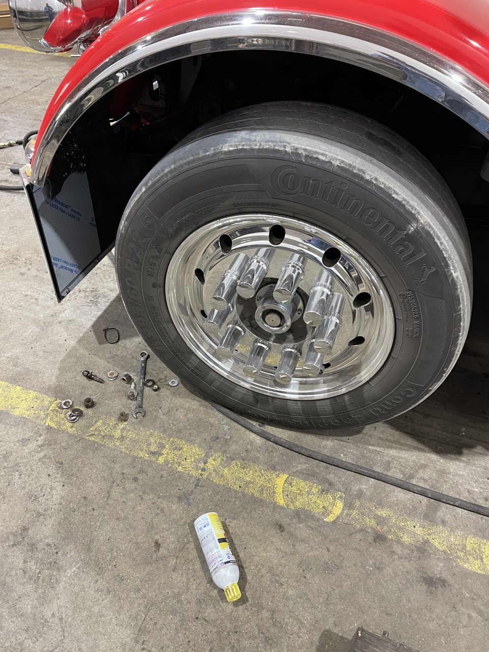

    I run these and most other car haulers run this size. I run heavy on the steer when loaded with a 14,600 front axle. I don’t know if there would be any advantages for you to run them but they ride just fine and handle weather great. I don’t run them more than 100,000 miles because I pull them off early to use on my trailer. I use a 3.25 offset flat faced wheel that gives them a wider stance and they wear perfectly even. 988BE518-DDC2-4AD8-82F6-22AE70B844E5.jpeg

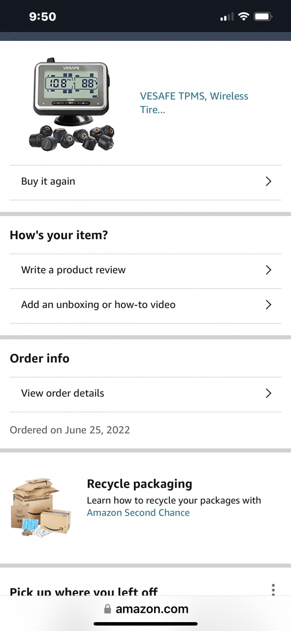

    I use these and keep an eye on my tires all the time. I bought them to keep an eye on my drive tires but they will monitor all 18. 8836C006-2B1B-4D9F-839C-274A015B2C4A.png

    I will check those out. These would be perfect. Thanks
