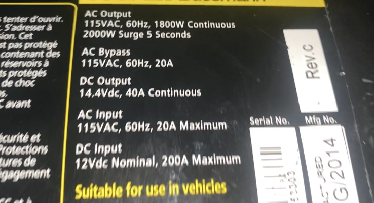

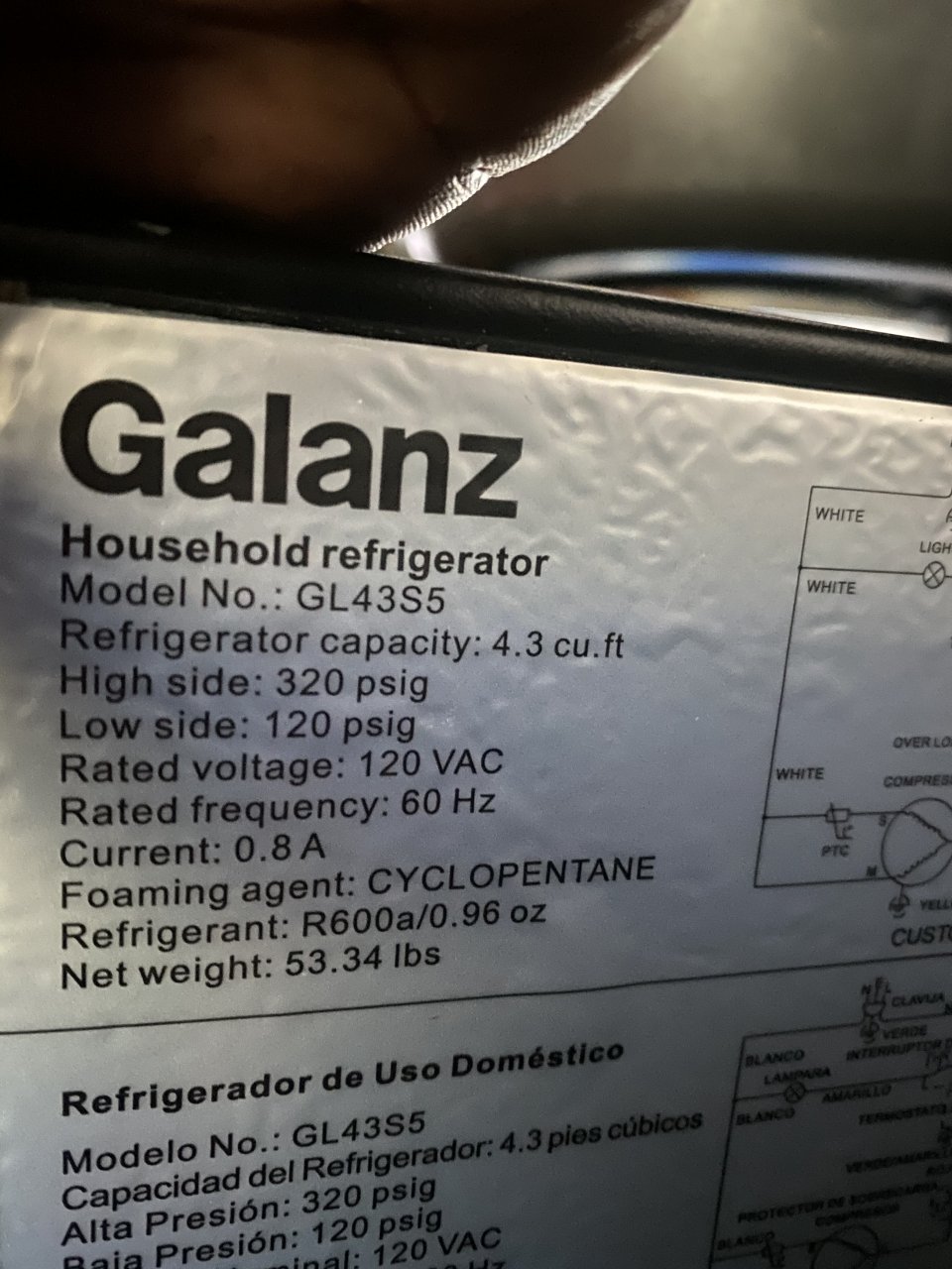

    I got a small fridge I’ll put specs below , my inverter is 1800w. 2000w surge. Then I drove 400 miles and now truck won’t turn start sound like dead battery. I’m in Indio California at Love truck stop.
    what you guys think
    Inverter is bad
    Battery are bad
    Fridge is over kill?
    Bonus question I have a electric apu.
    Can I jump star the truck with the those batteries?

    If it is 15 volts it’s overcharging the batteries.
    Should be 13.8 - 14.2 volts.
    The fridge is not enough of a load to be the problem.
    If you recently wired up the inverter then I would suspect loose wiring connections as mentioned.
